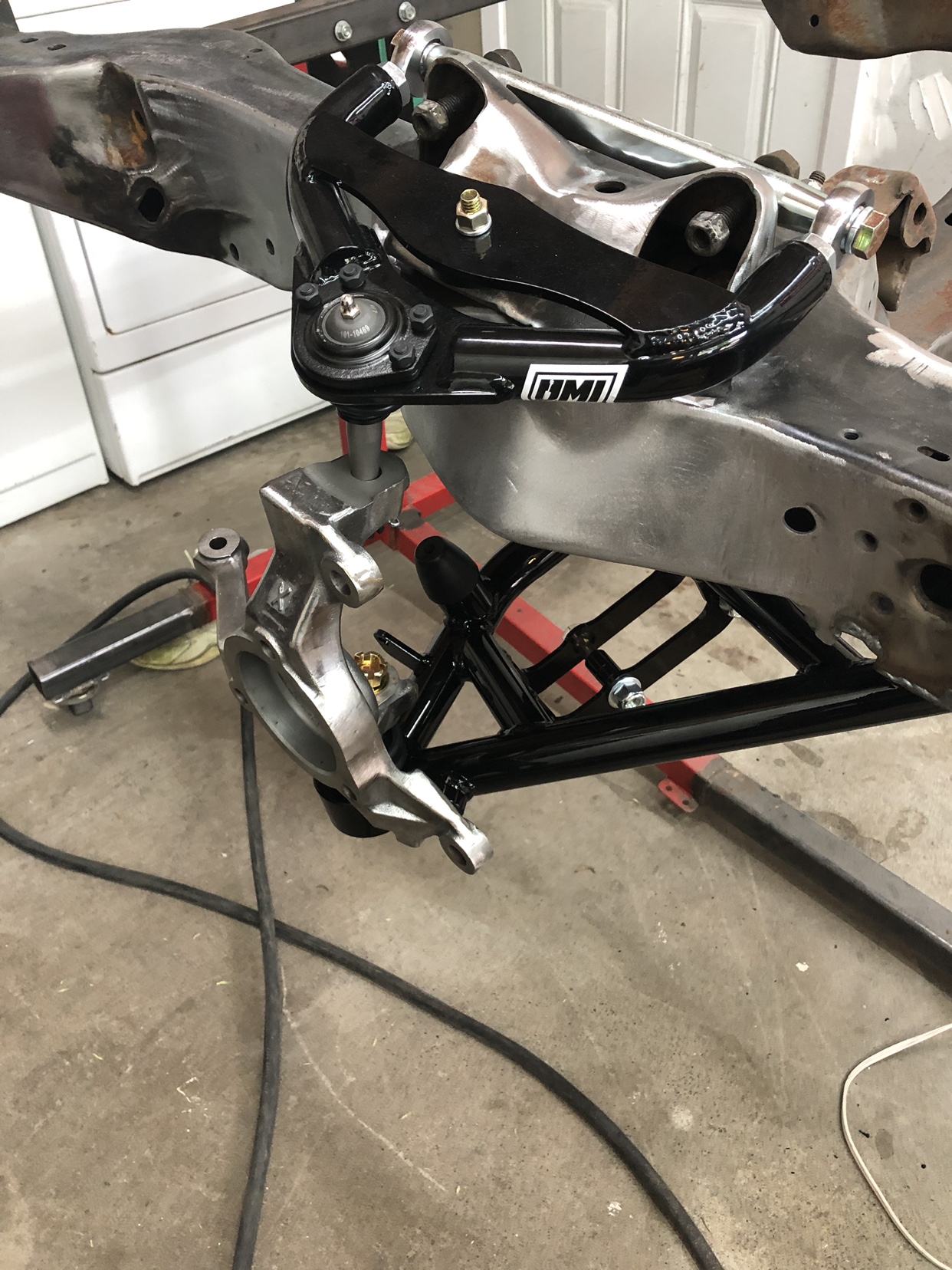

Front suspension
UMI Performance all the way!
Very nice, How come you like UMI that much better than Ridetech or even SSandC?
I would like to hear more about the AFX spindle conversion? I am researching a new suspension set up for my T-type and looking for info on the AFX spindles.

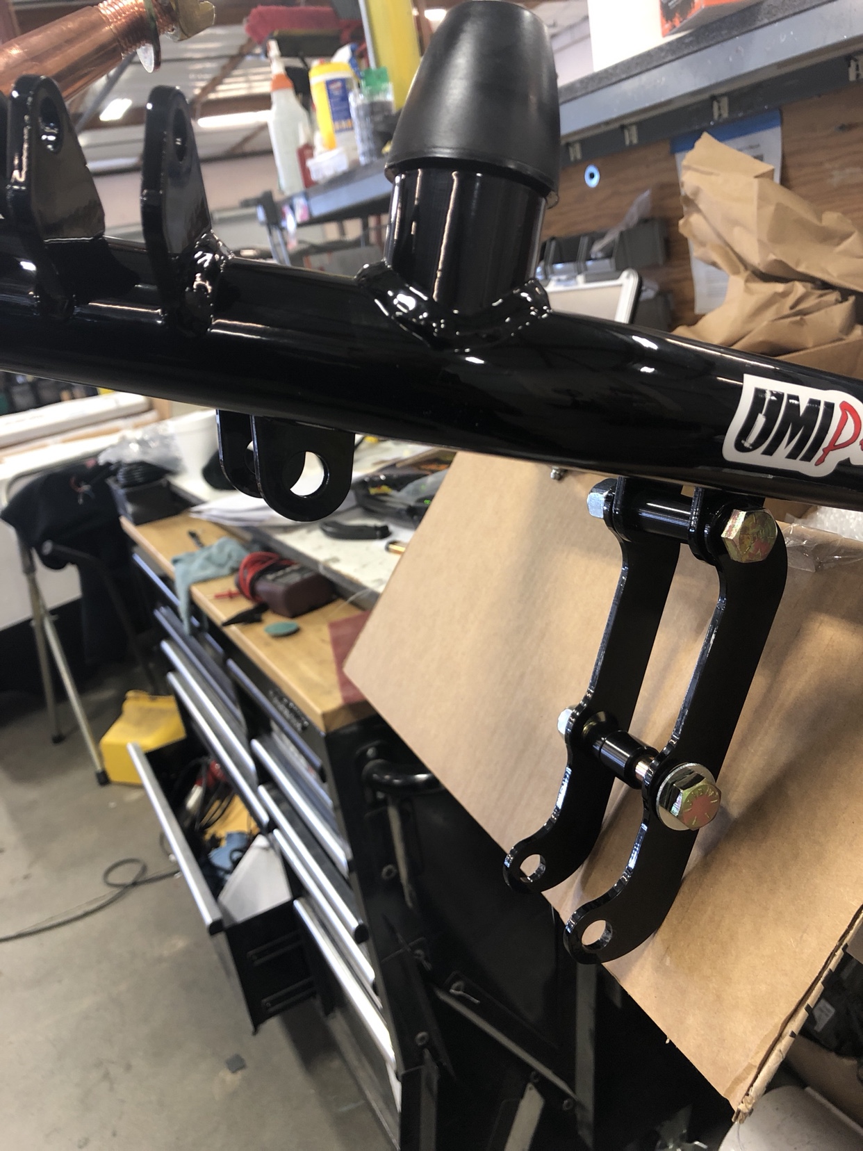

I like ride tech and scandc also. I just like the umi set up because I can change the Coilover just by unbolting from the bottom vs taking everything apart.

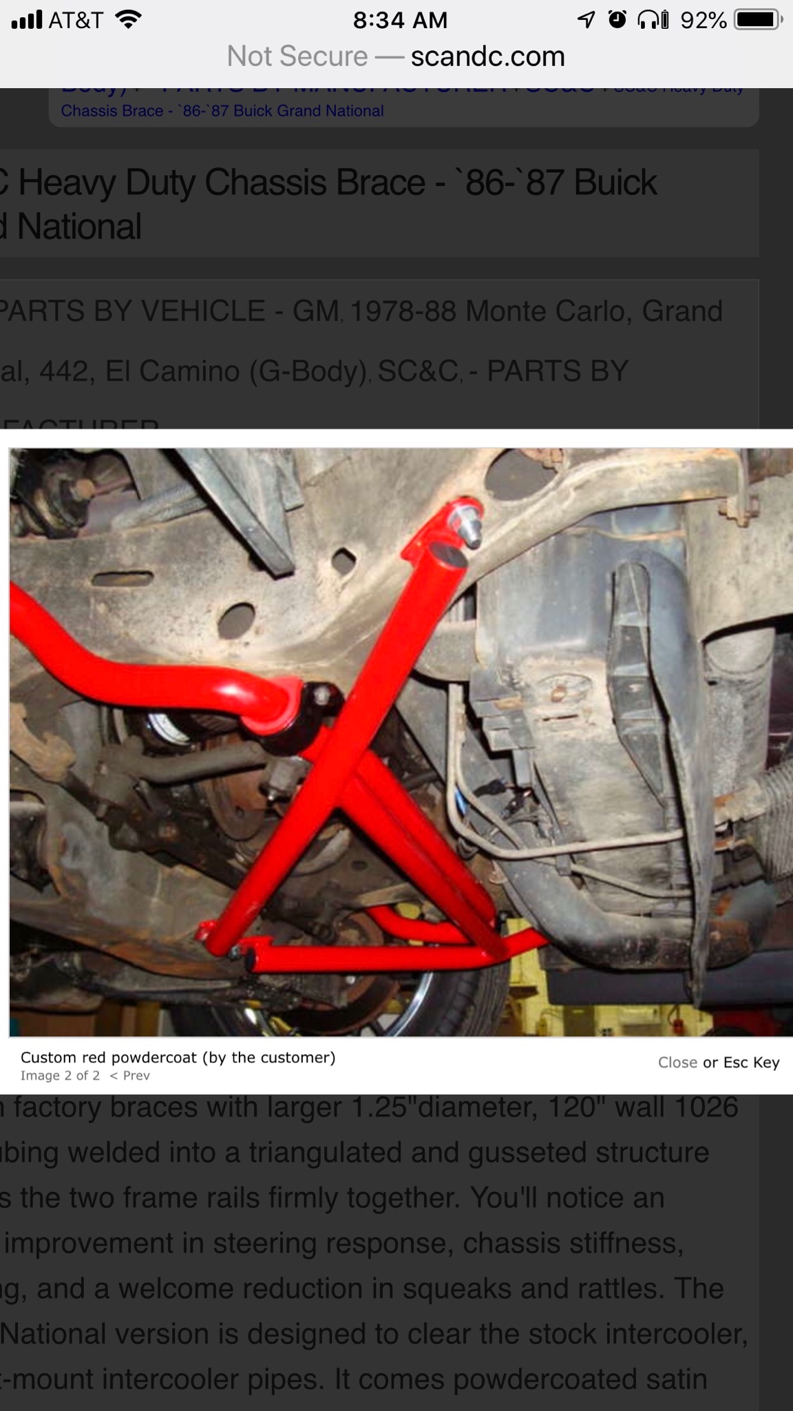

no one offer something like that. Incase I didn’t like the spring rate or Coilover set up. Plus they make so much for our cars. I figured I would keep it all the same. I will be purchasing scandc’s frame brace for our cars. They are the only company to make the front brace for front mount intercooler. Yet still keeping the connecting brace.
afx is nice as well just pricey considering you can just use blazer spindles at half the price
