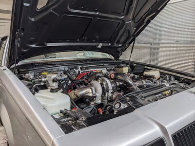

Good morning. Thanks for the feedback. I will just have to learn to be patient when filling up the tank. I just want to drive it. It seems like I work on it more than drive it! That's the price you pay when owning probably one of the finicky/ P.I.T.A. cars ever made! Had a boost leak. Had to get a new/different "exhaust housing" for Brand new Turbo. It did force me to go thru the entire "exhaust system." Headers, downpipe. crossover pipe. Everything is sealed and tight now! No More boost leak. It's building boost again.
