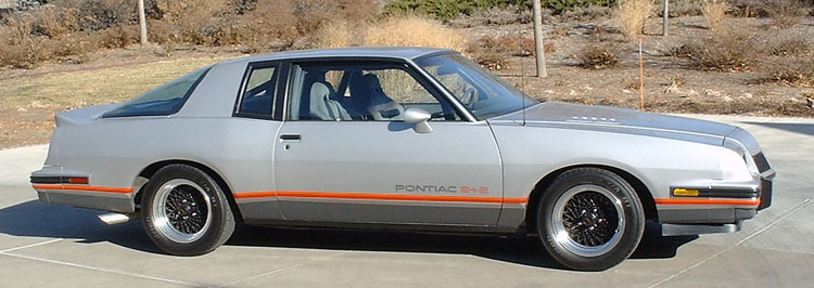

After 5 years of Open Road Racing my '86 Pontiac 2+2, I've decided to start heading this route.
The 2+2 is fast and fun and will run with Vipers and regular C5's on a FAST course (especially if its slick and rough) and is WAYYY easier to make fast and handle good vs. a classic "Muscle car", but it's still kind of a truck.
We'll probably always use the 2+2 on 100+ mile ORR's, but for the shorter ones, I'd like a car that will do 100-140 a little faster than we currently do, something wider with a lower center of gravity and something I can put tires bigger than 255 wide on without making it look too much like a race car. A 2.72:1 geared TTA should be the answer. I just need to find the time to begin the modifications.

UNGN,
Nice 2+2! I also have an 86 2+2 as my daily driver. Just got out of the car 5 minutes ago from a 300 mile "walkabout". For me that's a road trip to look at cars for sale. I do this at least once every 3 weeks. I thought I was the only guy who knew or cared about 86 Pontiac 2+2's! Found another one this week that is REAL rough however it may be REAL CHEAP.
What brand/size of wheels are you running on the car. I have just ordered a set of 18x9.5 and 18x8's ACE wheels for the 2+2 and/or my GN.

The wheels in the Picture are factory GTA "front's" (16X8) with 255/50 tires all around.
We have since gone to GTA "rears" in the front because the Baer brakes space the tires out enough we would get a little fender lip rub in hard cornering (cars behind us thought it was oil smoke, but the tires were smoking). With the rears on the front, the rub is completely gone.
The grand prix's rear fenders seem to be a little narrower than a buick because our 255's are against the frame as close as I feel comfortable (3/8") and yet the outer edge of the tread is even with the fender lip while 275's fit easily in a buick. 9.5" wheels might need a frame notch or the fenders massaged out to work on a 2+2.
