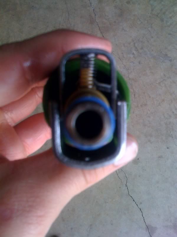

How in the world do you keep from throwing the governor spring? Its happened 3 times now and im bout tired of pulling the pan Any help is appreciated guys

What I do is cut a small length of wire off of an old PR spring, straighten the wire and put a small hook on it. I then tack weld the wire to the small weight and grind the tack weld down slightly to end up with as little weight added as possible. The amount of weight added is not noticed in the shift pattern.
It does require a little talent with a tig welder to do a nice, clean job of it.
I've found that you only need to support the spring halfway down through the middle to keep it from blowing out.

Should work fine. For those wondering its a spring retainer from a non BR governor. Usually its flipped around 180 degrees and the heavy weight has a light spring on it unlike the BR that has only a light spring on the secondary weight. As long as the retainer doesnt limit the travel of the weight you are good to go.
Yeah I checked that I compressed the weight and held it up to light and you could see clearence so thats it. Ill make a blast here in the next few days and update if it holds or not but ill cruise and enjoy it for a while just not quite ready to drain the fluid and pull the pan one more time if it doesnt hold.
