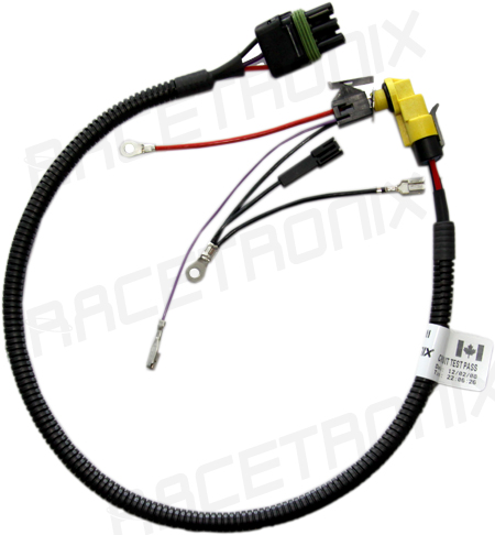

Yes it will work for testing.
The hot wire uses a fat new red wire to supply pump power from the alternator post through a relay contact, the factory wires are used to trigger the new relay only and don't carry the fuel pumps current , excepting the ground wire, but that is a shorter run to the pump. Make sure the ground is upgraded as well for best results. A gas tank strap wire to the rear frame works if the frame is grounded up front to the battery.

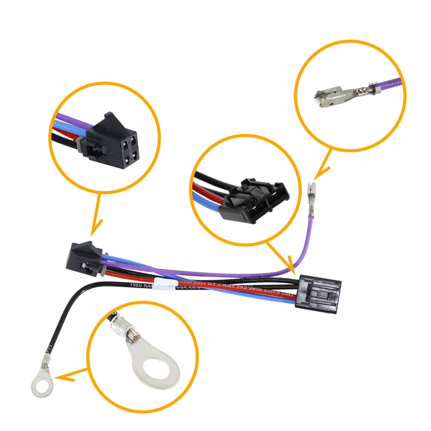

Thanks. Anything electrical baffles me. Guessing the ground wire is the black one in the pic. How do I upgrade it? Clip it, splice in another & run it to the frame? I’m getting the grounding strap for the battery to frame upfront, but not sure what to do at the rear of the car. Thanks for your help.

You are correct, it’s only as good as the stock wires in the tank.
You can beef those up too.

Preferably you would splice it, heat shrink it, & run a ground wire all the way back to the battery.
I did mine(DW400) & took a 10ga wire from the sending unit/ground wire to a DIN rail I have that’s connected to the ground(negative) terminal of the battery.
I went crazy on my grounds though. Negative battery cable on block to frame, negative on battery to DIN rail, DIN rail to a secondary DIN rail on firewall where my TR6 is grounded along with many interior(gauges wideband, etc) items are also grounded. Plus I moved all of the grounds from the back of the pass. head to the intake.
Can’t have too many grounds to me. Sorry for the thread hijack.
Original plan was to replace the pump with the Walbro 255lph and use the stock carrier/sending unit. Instead, I’m getting the Racetronix GEN w 255lph with carrier/unit for factory digital dash. It’s only money, right. Thanks for all your replies.
