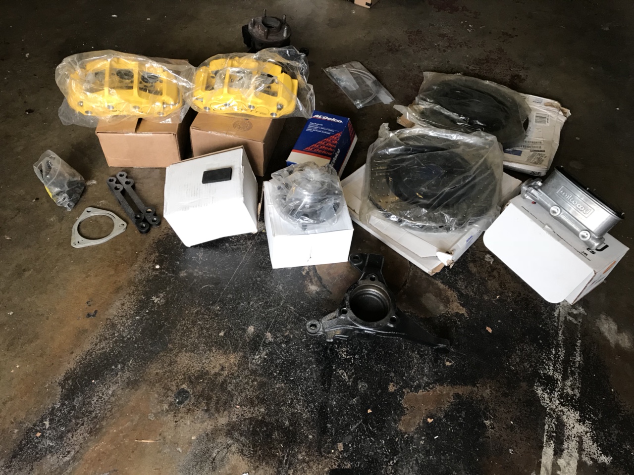

I say go for it. Just have to make sure the master cylinder is able to fit with the hydro booster. Some have a retaining piece that gets stuck and your brakes wont work then.
I had pix in that thread but thanks to Photobucket for nothing. If you need pix of anything specific I can post them.
You need 1.125" (1 1/8") bore. Also a modification kit to adapt the HB unit to the wilwood cylinder so it won't scrape and bind on the snap ring in the master.

Plus $25 to shipI'd say you better budget about $850 with Wilwood master Cylinder included
I got my hydro boost system from Tallon Hydraulics last summer... I think the whole thing was $900 but that included the master and a full hose set. It came with detail instructions that made it a straight forward install. They were also very helpful on the phone with the few questions I did have.
I just checked my system and after I shut off the car I got 3-4 good 'assisted' pushes on the brake pedal.
My advice to anyone doing this conversion is to:
1) buy a new unit... I have seem so many posts of issues and more often then not time it came down to a remanufactured unit.
2) I have a PCS large PS fluid reservoir... the extra capacity helps prevents cavitation of the fluid and also helps keeps things cooler. With the stock reservoir I had some of fluid cavitation and some not great low speed steering performance.
3) I also sent my PS pump to Lee Steering on CA and had it optimized for hydro boost. This greatly reduced the noise and it greatly improved the low speed power steering performance. The car steers like my dad’s 82 Rivera (that is a good thing).
I am not seeing the full hydro boost benefit yet as I have stock brakes... that will change this summer as I am going to do do the C5 Corvette 12" brake swap in the front. the back already has S-10 drums that I will probably leave.
