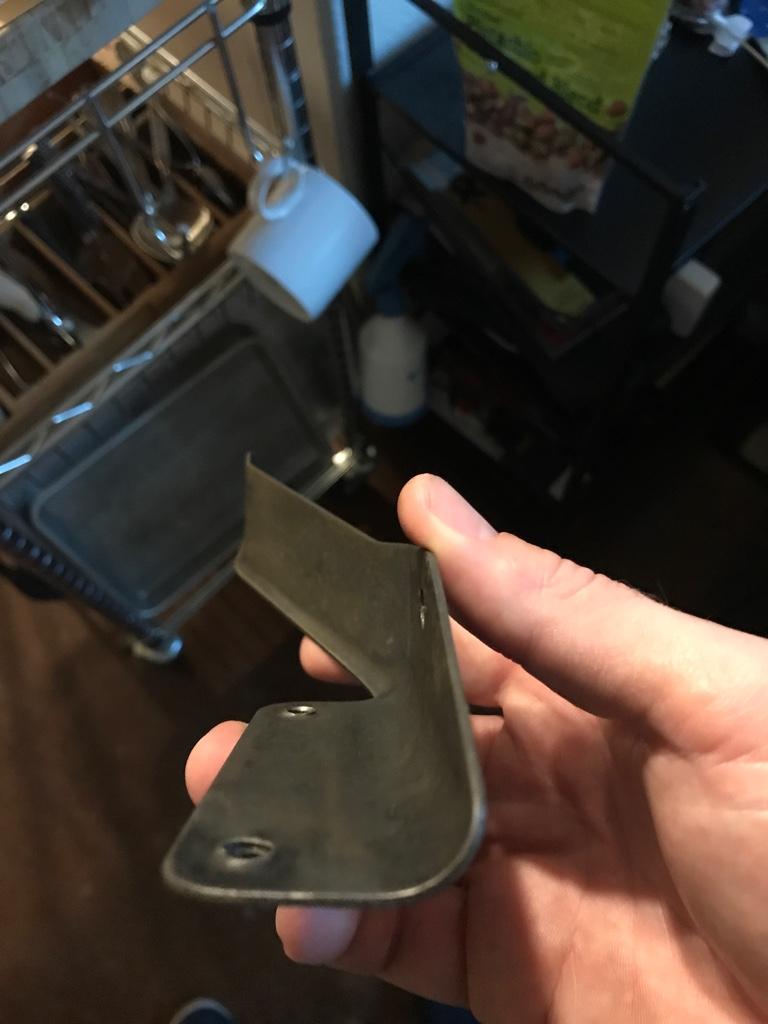

Can anyone post pictures of how they mounted their PSC reservoir? There are lots of old threads talking about it but most of them say to reference the pictures that were posted to the thread. Unfortunately all of those pictures are gone. Appreciate multiple pics and methods. Thanks!
Can anyone post pictures of how they mounted their PSC reservoirs? There are lots of old threads talking about it but most of them say to reference the pictures that were posted to the thread. Unfortunately all of those pictures are gone. Thanks!
I drilled some holes in the factory bracket. It has worked well so far. At some point I’m going to pay someone to fab something up and have it painted or powder coated. Someone with some metalworking skills should start making these for our cars. I’d pay for a decent piece.

On the bracket I made one painted it flat black
I couldn't use the stock one because I have high pressure hose there ( My car is a 84GN) so I'm a little different
