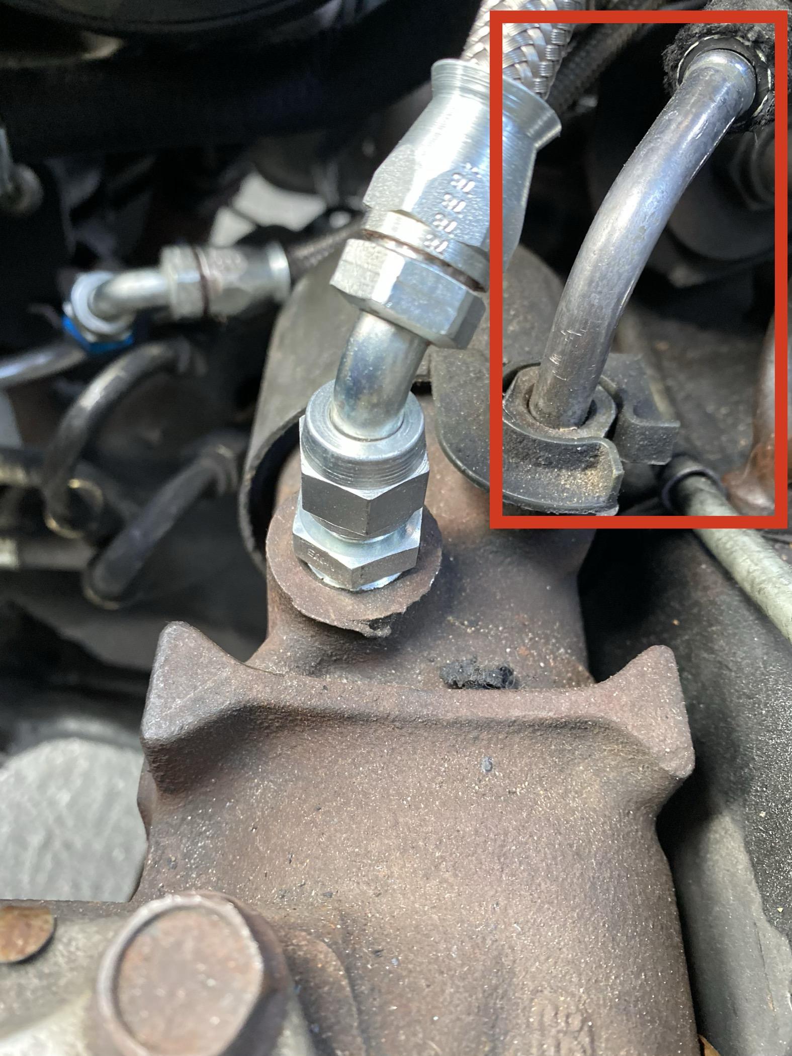

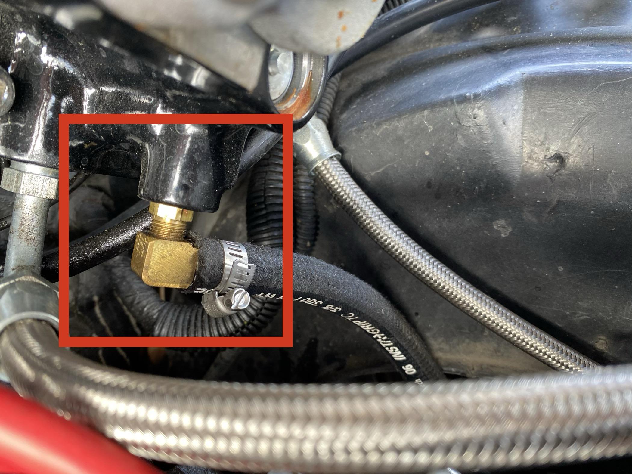

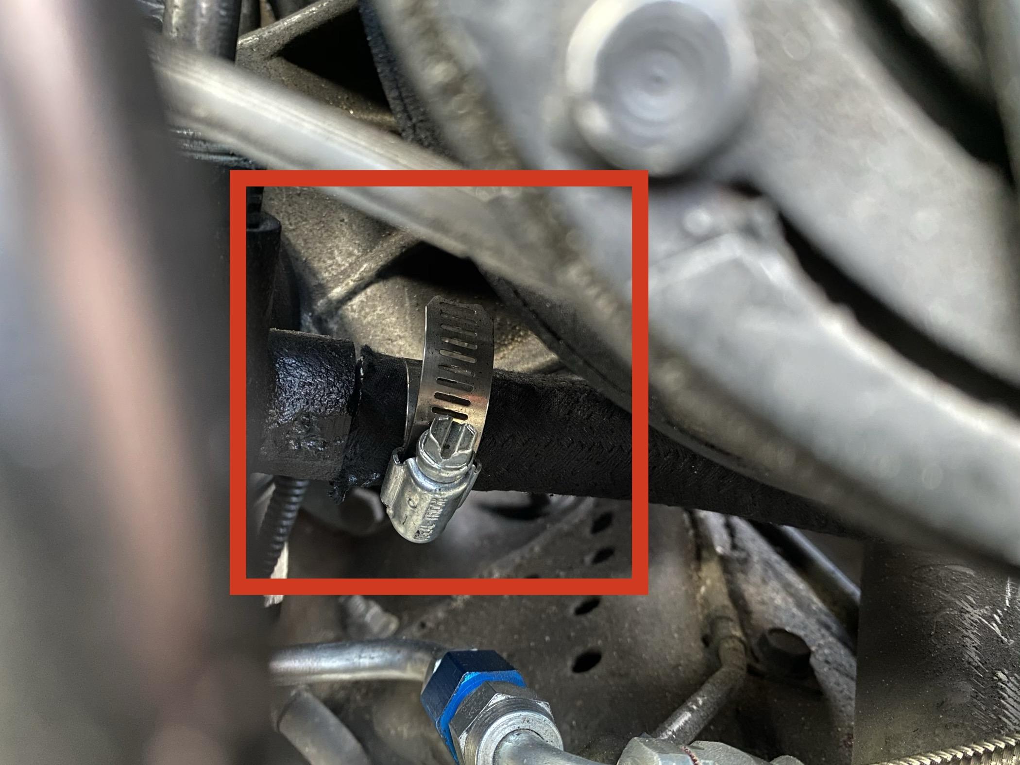

468faa781457d4da701402bae8938feb.plist
Left connector from reservoir to PS pump
4eb73c384e5740993d48b28de134e342.plist
Right connector from reservoir to booster
fac7f00d421e8ee323264569e5a57f14.plist
Center connector from reservoir to steering box
So no specialty connectors are necessary on the "far" end of the reservoir lines. The high pressure fittings I used came with my Hydratech kit so I can't speak to those as well.
