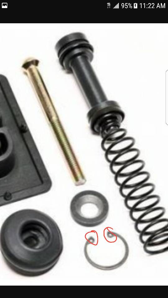

I would check the C-clip that holds the piston in the master cylinder on the wilwood unit. The clip needs to be changed out so the master cylinder shaft doesn't drag and hang-up on the clip. I just tossed the factory wilwood clip in the trash the other day or I would show you where it hits. Basicly the circle piece that the tool grabs to compress it and remove it is to big and it hits. You need a clip that doesn't have it or has a very small one. Picture of what I'm talking about attached. It drags on the lips
I would check the C-clip that holds the piston in the master cylinder on the wilwood unit. The clip needs to be changed out so the master cylinder shaft doesn't drag and hang-up on the clip. I just tossed the factory wilwood clip in the trash the other day or I would show you where it hits. Basicly the circle piece that the tool grabs to compress it and remove it is to big and it hits. You need a clip that doesn't have it. Let me see if i can find pictures online.
People do that to the factory unit but it's not the right way. There is a modification kit for the factory unit to replace the rod. Aftermarket units come with a narrow rod to engage the MC. You replaced the factory snap ring with a wire snap ring. Wilwood told me not to do that, gave me a number and I ordered a kit from that place.
Glad they make something for that. My snap ring is holding just fine. Lol
I would have done it that way too. A lot of people have. I asked wilwood first though and they referred me over to a hydroboost company. I do a ton of brake conversions and if it's for someone else's car, I have to be sure it's 100% that's all. (y) Hydroboost can be finicky but damn they stop!
