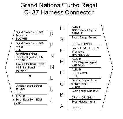

Hey I need to set my IAC but I dont have the ACLC plug under the dash. I've just spliced stuff into the C437 plug near the ECM and Im wondering what plugs to cross in the C437 plug in order to satisfy the IAC reset procedure in this link: IAC Reset Procedure
From these charts I think I need to cross the M and E plugs, which is really just grounding the E plug. Is this correct?
