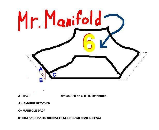

Did you use a high-tech CAD program to draw that up Earl? You kill me with crap like that. True as can be but looks like a third grade caveman drew it. LOL.

A day in the life of Earl.... - TurboBuicks.com
Shortly after I drew this picture to help others decide how much needs to be milled.

The angle between the intake face and deck surface on the Buick V6 is 90 degrees. So you don't need Earl's formula to figure out how much to cut off the intake face. If .125 was taken off the head deck surface (WOW that is a ton!) then, .125 off the intake surface of the head should correct the problem.
