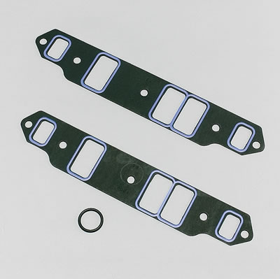

so just to clarify, its the one-piece metal valley pan, in addition to a set of regular style gaskets which just go around the ports (essentially the picture you posted plus a set that looks like this)
Or do you mean that the pan also seals around the ports and that is all that is needed?
If you have a fel-pro part number handy for a kit that includes everything I'd need that would be VERY helpful.
Sorry for being an idiot, I just want to make sure I do this right the first time, ya know? Also, if it is the metal pan plus the gaskets I showed, on which side of the pan do the regular style gaskets go? I would assume between the valley pan and intake, rather than between the valley pan and head? Thanks for answering my annoying little questions, this board is priceless to me anytime I do a job on my buick for the first time, it assures me I'm doing it right... who needs a haynes?
I have always used just the pan never heard of using two gaskets. Have used a little spray on Permatex in the areas around the ports as well.
I am showing that the Fel-Pro Part Number is MS96037. Might want to double check before you purchase.
all you need is the felpro set im in the process right now replacing the valley pan gasket since two of my lifters don't want to play any more.
You can use either. The Felpro 1200 is for the stage I heads and it can be used on the original by itself. You don't need both, but if you use the 1200 you will need to cut the valley pan off and mount it in the valley to keep oil out of the PCV valve.
