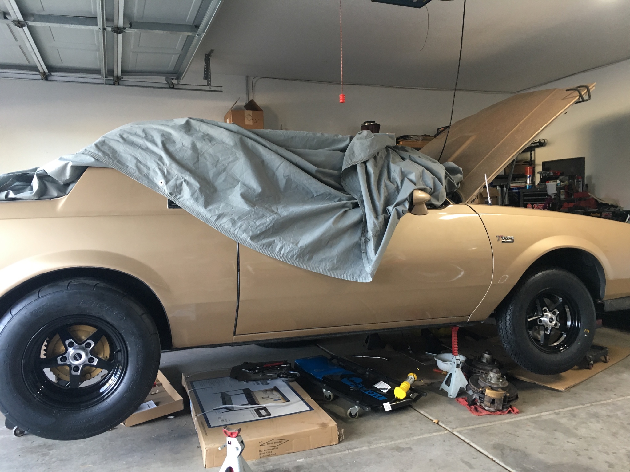

That thing looks outright menacing............
Well played, sir.![]()
Thanks man. I'm happy with the way it turned out!
SignUp Now!That thing looks outright menacing............
dont need one with these fronts
Think used a small spacer to push them out, more for looks in guessing.
Got the 15x10 ssr spike and they weigh in at 18 lbs evenLooking badass.........did you happen to weigh them?
Well this is really the tire I'm looking for, not sure how she's gonna 60' thoughWhat tires are you planning on
Lol... in all seriousness thinking of a MT Drag radial or something similar either in 50 or 60 series. Thinking of buying one of each and seeing how it looks on the carMight have some trubble hookin' up with all that there amor all on them there tires son.
Looks awesome, but that tire is going to go threw some trauma if you drive it on the street and hit a couple bumps. looks like your offset for those rims are not ideal for those tires. Back spacing needs to be around 4 3/8" for a 275 on a 10" rim. You can raise the rear and put some air bags in if your stuck with what you have, or try a tire that isn't as wide and have that much side wall bulge.
That's a great lookMy new setup I have. Wheels are cheap, and seem decent![]()
That's a great look
