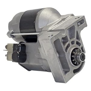

The '96 Vettte (LT1) starter is much smaller than the DB one. The starter MUST be from a Vette. The Vette got a compact gear reduction starter. Oh yea, it weighs around 8-10lbs.

This is the real deal gear reduction starter. I just purchased one from a local salvage yard for $42.00 0ut the door. The guy was impressed by what he felt and heard when he tested it.
