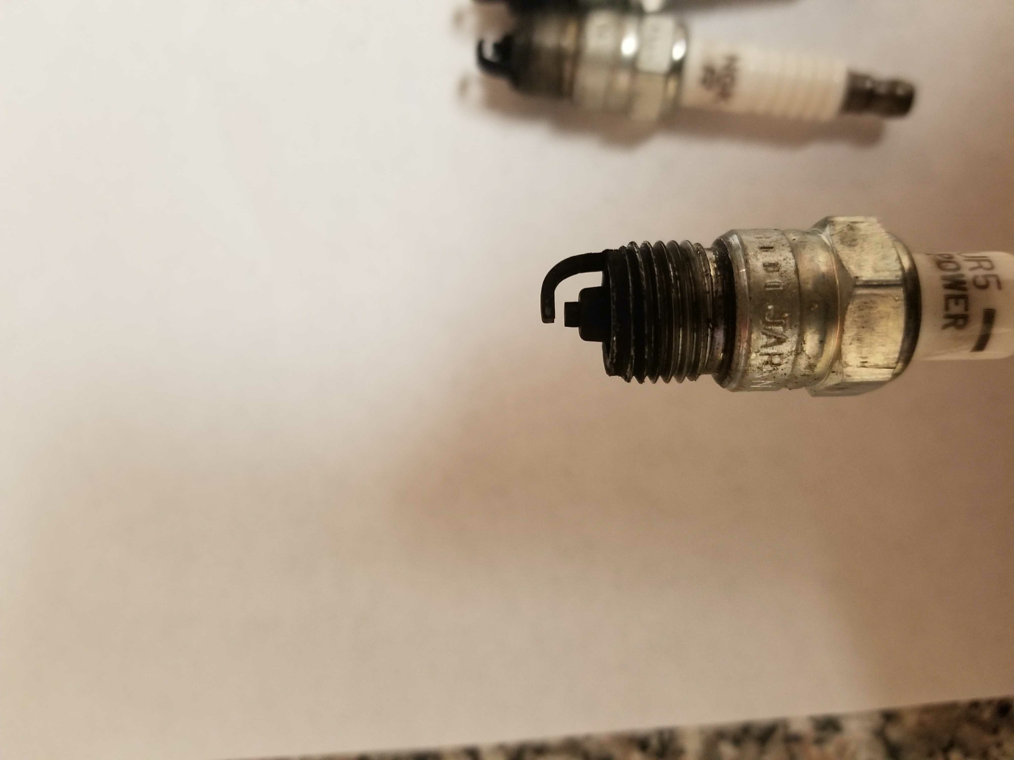

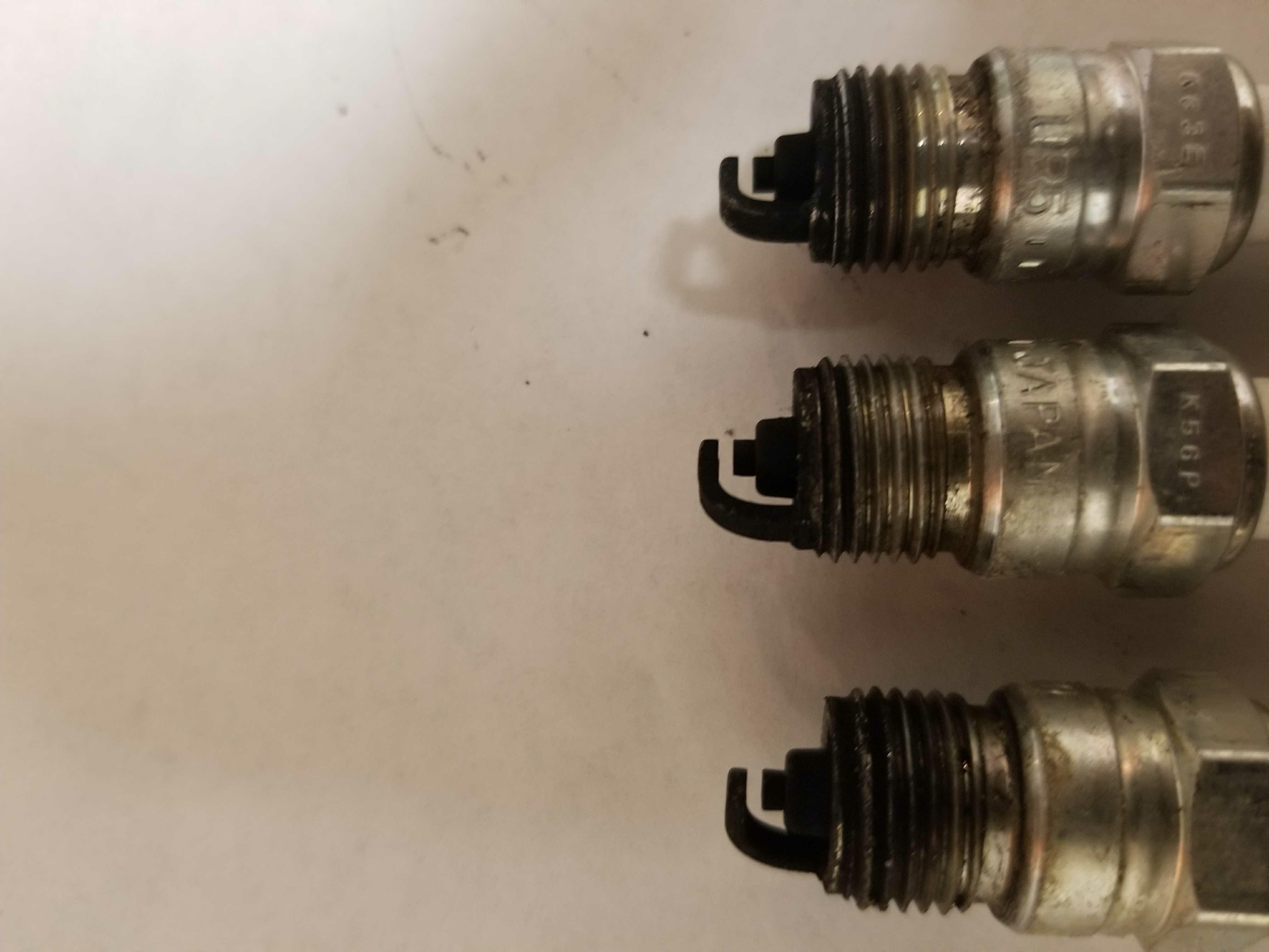

The plugs are black smell of gas and all look like these. Any ideas?
I'd start with a new set of plugs. You can't be lean for real and have plugs that black.
They are dark but not wet. I highly doubt the plugs are the the reason for no start. You're not getting fuel IMO.
They were a little wet ,but it has been a week since I messed with the car. I'm sure they were really wet at the time the car wouldn't start
