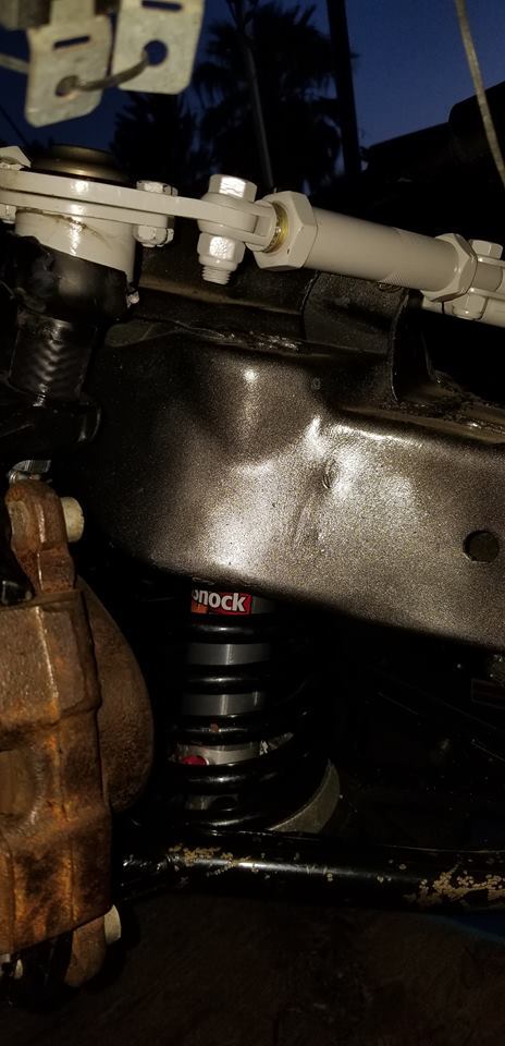

Here is a picture of my dirty SPC lower control arms and the modular spring pocket at the bottom of the spring. It is the grey piece underneath the black spring, that you can see is in a circular shape around my Varishock QS2 shocks:
Another pic of my dirtyass arms showing the spring pocket:
FOR REFERENCE, What the control arms look like without the spring, shock, or modular spring pocket installed:
