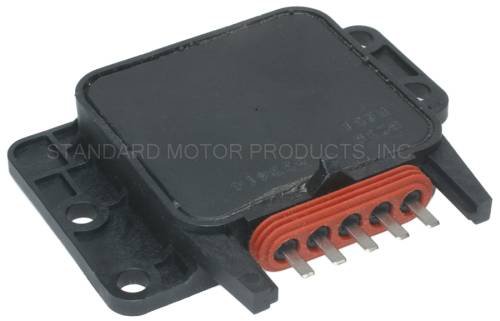

The first design looks like a box about half the size of an 8-track.
The second design looks like a later model ESC:
Each has it's own short wiring harness. I always wonder if I used the second design harness if I could plug in a ESC module and knock sensor from a '84- NA Buick V6. (When they in the junkyards, you could grab them super cheap)
Might be worth considering to try if you can find one (proably easier than finding a good Turbo Control Center.
