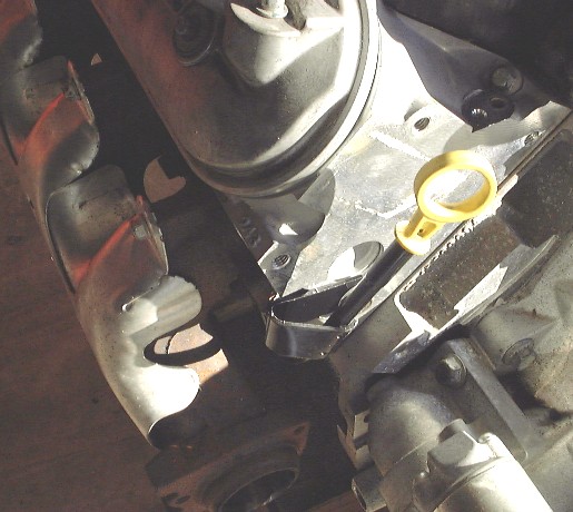

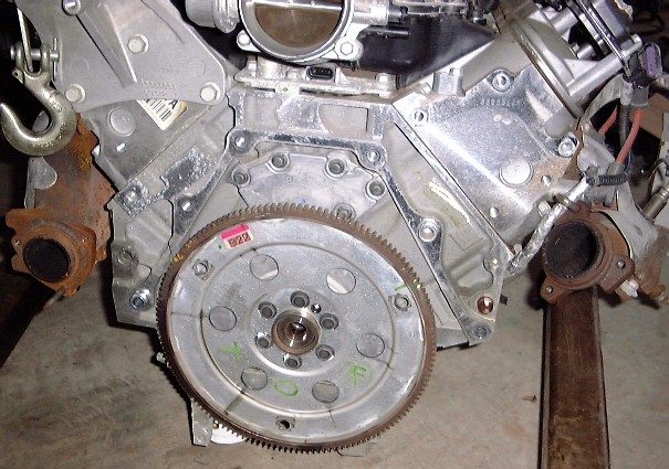

been doing some reading and see that both stock truck manifolds wont work turned around.. only only on the driver side.. i was doing some thinking and thought about the fwd ls4 manifolds.. its looks like the one that would be drivers side would clear better than the truck manifold flipped around.. anyone have an exp with these?
wont let me post pics or links without having more post.. im more of a lurker :smile: but i searched for a ls4 pullout on ebay and used those pics as a refrence..

With the LS4 manifolds, ive looked into it and it would work great on the pass side, going up and forward, but i think it would still be too low to have on the drivers side. I know of no one that has actually bought one and tried, so thats really your only option. Good news is you can still use it on the pass side so you wont be out any money
BTW, the truck manifolds really dont work on a g-body, the drivers side only works if you change the steering to rack and pinion. I would look into switching though, its about 50lbs lighter and feels way better. Not bad for $600 either.

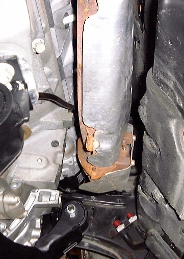

search my posts in this section, i have pics of it up and everything. The thing about the LS4 mani is you would use the same manifold for both sides, one up and ahead, the drivers side down and ahead. I havent gotten to see one to measure, but it just may clear the frame, but it could just be too low. Get what im saying

Beat me to it, I searched and found some pics. That was my main concern was the manifold sitting to low and hitting. The only thing that looks like it would be in the was is the thermo housing which doesnt look like it would be a big problem..
These are some of the better pics that I came across..

Guess I should have claified that all I was looking into that has to do with a ls4 is just that one exhuast manifold.. It would be the iron block 5.3. Im just wanting to see how 'cheap' i can get this done without sacrificing quality on the turbo parts.. A 5.3 can be had cheap enough that it wouldnt be a big deal to me to later build a forged 6.0. At that point I will already have everything going and the swap would be cake.. And yes I know turbos arent 'cheap' it comes up everytime someone on ls1tech someone says budget and turbo in the same post.. But it can be done alot cheaper than alot of people think if you have any sort of fab skills..
