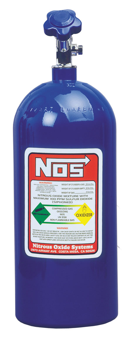

garyk1970,check for all leaks,warped flanges,cracked headers etc,a smaller exhaust housing on the turbo,a good quality converter,nitrous.pick one but all 3 are fun:D
I prefer the carbon fiber thank myself. Some others prefer the non sulfur N2O:rolleyes:
Yeah those CF bottles are the cats whiskers... but I just couldn't justify the extra 2lbs capacity and half the weight at twice the bottle cost. :D
I could keep two full aluminum bottles in the trailer for what one of those CF bottles cost. ;)
