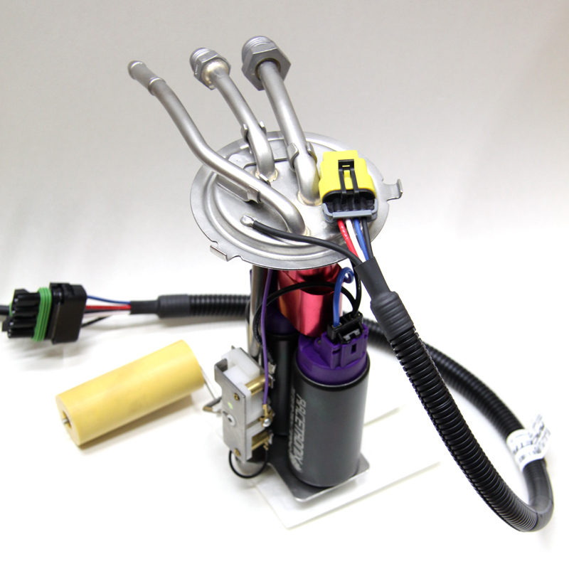

The DP is designed with all the best components possible while allowing it to be serviceable.
The most relevant question is whether or not the system delivers the fuel you require using dual 255LPH or 340LPH pumps.
We have posted the flow specs for both pumps.
Q1. Is the Hobbs pressure switch included with the DP system?
A1. The Hobbs pressure switch and interface harness are OPTIONS you can select via the drop-down menu in our web store. These are listed as options because not all customers require them. Some customers have computers, which can control both pumps via the jumpers (shown in our picture) on our dual harness. Some customers have upgraded return lines and chose to run both pumps all the time. We recommend using either your computer or our Hobbs switch to control the second pump. This reduces the electrical load, fuel heating and wear on the secondary pump. The primary and secondary pump may be easily switched by swapping the control jumpers if you wish to balance out the run-time on the pumps. The DP harness comes with both control jumpers plugged in as shown in our ad. In addition to this the DP harness comes with a Weather-Pack connector so you can interface the secondary pump control to your aftermarket computer or any pull-to-ground signal.
Q2. Can other pumps be used in the DP sender as an option?
A2. Only Walbro 255LPH, Racetronix RXP340M and Aeromotive 11140 340LPH pumps will fit through the tank opening side-by-side. It is a VERY tight fit. The DW and Siemens will not fit!

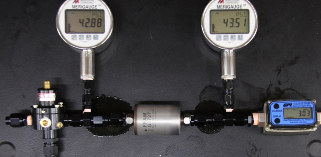

Q12. Is the factory filter able to flow enough for the DP system.
A12. A clean factory filter is more than adequate. We do not recommend most aftermarket cartridge paper filters or SS mesh filters. The idea here is to protect the motor.

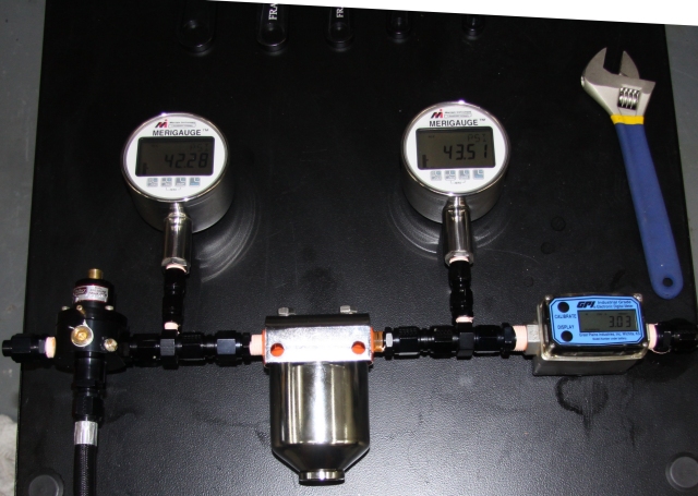

Q-SPEC. What are the performance specs of the DP system?
A-SPECS:
These are the typical specs with 2 x Walbro 255LPH pumps:
500LPH @ 43.5PSI @ 13.5V @ 15.9A
425LPH @ 58.0PSI @ 13.5V @ 18.5A
625LPH @ 43.5PSI @ 16.0V @ 17.6A
577LPH @ 58.0PSI @ 16.0V @ 20.6A
345LPH @ 80.0PSI @ 13.5V @ 23.4A
432LPH @ 80.0PSI @ 16.0V @ 26.2A
These are the typical specs with 2 x 340LPH pumps (UPDATED 2/15/13):
680LPH @ 43.5psi @ 13.5v @ 22.5A
820LPH @ 43.5psi @ 16.0v @ 27.5A
635LPH @ 58.0psi @ 13.5v @ 24.5A
790LPH @ 58.0psi @ 16.0v @ 29.5A
550LPH @ 80.0psi @ 13.5v @ 28.0A
710LPH @ 80.0psi @ 16.0v @ 32.5A

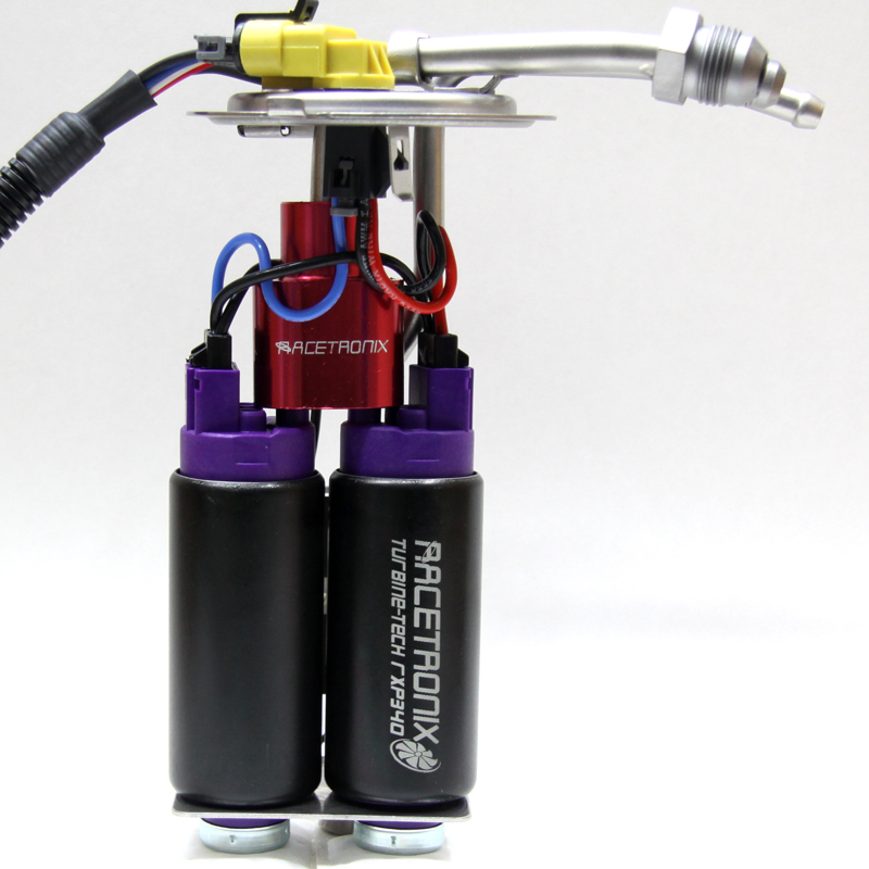

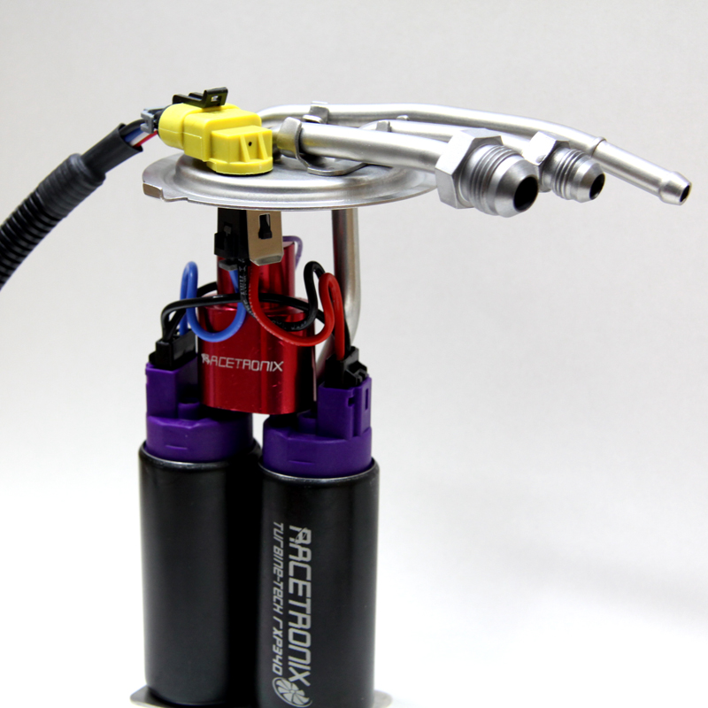

Racetronix DP systems now feature our new RXP340M Turbine-Tech 340 L/Hr fuel pumps. New lower pricing on DP systems with 340 L/Hr pumps and AN option.
The new purple pumpers :D
Q. What are the performance specs of the DP system w/2x340LPH pumps?
A. These are the typical specs with 2 x 340LPH pumps (UPDATED 2/15/13):

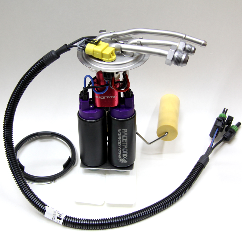

We have separated / moved our dual 680LPH fuel pump system to a separate item in our web store to avoid some of the confusion with our previous listing:
It is currently on sale.
http://www.racetronix.biz/customkititems.asp?kc=DPFS-G7680AN&eq=
These are the typical specs with 2 x 340LPH pumps:
