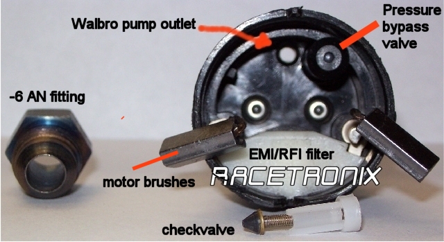

Q7. I already have some Walbro 255LPH pumps. Can I use them with your system?
A7. Only the GSS340M and GSS294M pumps can be used with our dual pump mount bracket. This bracket is designed to accommodate pumps with a machined 22mm centered inlet ONLY! The non 'M' version of the GSS340 supplied by other vendors will not work (this is for a mustang application). The GSS341, GSS342, F20000169 pumps will not work. Please note that you are responsible for any damage or lack of performance as a byproduct of installing your own pumps.
Q8. I have heard some bad things about Walbro pumps on this forum. Are there other options?
A8. This is old news. The pump in question was the F20000169. Racetronix never sold this with any of our Buick-specific kits. Racetronix has always bundled the GSS340M pumps with our kits so our customers did not have the multitude of problems people had to deal with YEARS ago. Racetronix is currently bundling the GSS294M with its single and dual kits. This pump has the same guts and spec as the GSS340M. Racetronix adjusts the pressure relief valve on the GSS294M to guarantee improved performance at elevated operating pressures.

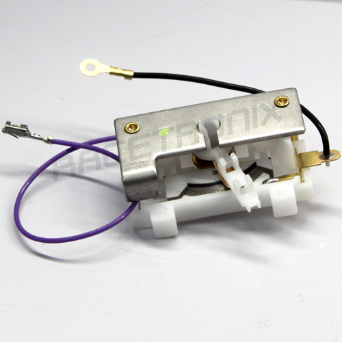

Q9. I have a digital dash car. Do you have a sender for me?
A9. Yes, we have a 120-ohm level sender for the digital dash cars. A drop-down option has been added to our DP system here: http://www.racetronix.biz/customkititems.asp?kc=DPFS-G7&eq=

Q16. Do you offer a -10 / -8 outlet version of this sender?
A16. We do not offer a -10 / -8 outlet version. The -8 / -6 version is more than large enough to support the fuel volume two pumps provide. You can see the outlet comparisons here for a comparison: http://www.racetronix.com/images/Fuel_Pumps/Walbro_pump_head-a.jpg
The outlet tubes will not easily accept larger fittings. If your motor really needs -10 / -8 lines to support the HP it produces then perhaps a dedicated external fuel system is worth considering. We offer in-line Weldon gear and Walbro screw pumps in our web store.
