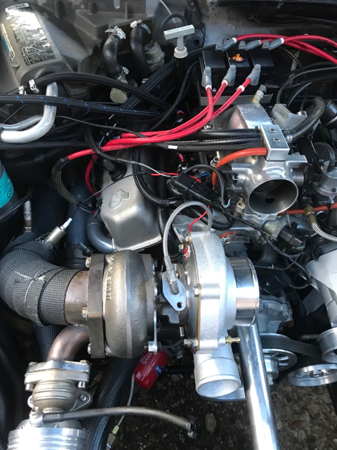

I recently switched over from a 66 mm turbo to give you 70 mm Percision turbo. After the install I now notice that once I get out of the thrittle there’s no chipmunk sound?? Can anyone help me understand what may be wrong
How much boost? Which cover? Ported Shroud
What kinda cover do you have on the compressor wheel ? Also is it a new turbo?
I’m not sure. The turbo is 6766 precision brand new in the box. Gn1 3 in downpipe with external gate

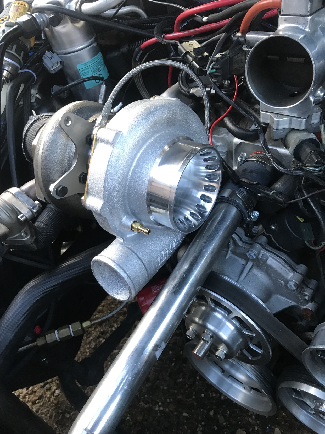

U don’t have a blow off valve correct? Post a picture of it
this was during install. No bov... it was installed just as my old turbonetics was.
You have a ported cover bud
So it bypasses the compressor wheel .thats why no horse sneeze
I appreciate it! It all
Makes sense now lol!!! I am a bit new but wanted to make sure I hadn’t done something I shouldnt
Looks just like mine.
Don't worry, you did really good.
Yes, the ported shroud S cover does away with the sneeze sound on decel. When the throttle slams shut, the backed up air in the intercooler and piping, now has a means of recirculating, vs violently sneezing back through the MAF sensor and air filter.
