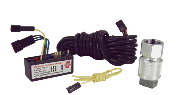

You might need something like this:
It will give the ECM the correct MPH signal so cruise will work and the dash a more common signal that works with most speedometers.

Thank you, I'll look into it.
It works…. I just did the same. I switched to the GPS speedo sensor as 2 of the converters that come in the kit have died. I wired the gps to the speedo and sent a signal from the gps sender to the vss.

I finally installed a signal splitter and the ECU now is reading the speed, but cruise still will not work. Supposedly the computer wants to see 2,000 ppm (oc) to get everything to work but when I set it for that signal the ECU gets no signal. I ended up having to send a 4,000 ppm (AC) signal to get it to work but cruise still won't work. if I go down the highway and touch the brake pedal, I can hear and feel the TCC kick off so It seems it wouldn't be switch related. When I turn the cruise to the on position on the stalk I can hear a relay kick on so it seems it's not a power issue. I have tried all the ppm signals, 2k, 4k, and 8k for both oc and AC and the only ones that the ECU see's the signal is 4k or 8k AC. What am I missing?
I had to tap into the signal wire at the cruise module to finally get it working.
