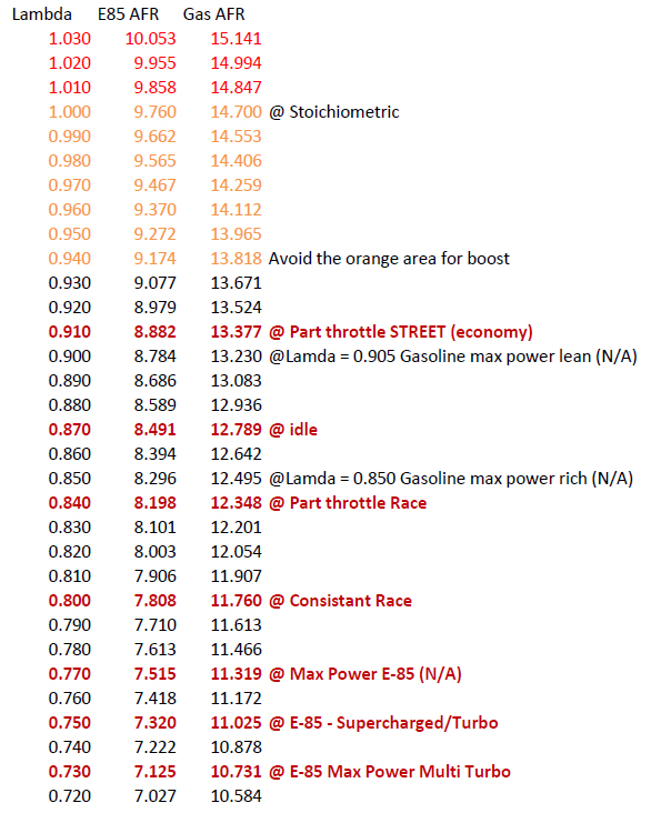

Got a hold of a table by Mark Sullens off Yellow Bullet Forums - Powered by vBulletin
Remember the scaling of the Air/Fuel ratio is dependent on the scale you are using. I prefer to use lambda as it takes the guess work out of the scale you use. Lambda is lambda no matter what scale you are using.
Use the Gasoline scale for A/F meters calibrated for gasoline even when using E85 as your fuel.
Here is the full table as a downloadable PDF file
E-85 Fuel Ratio download-able PDF
