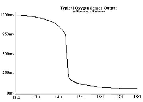

Hey guys iv got a question.. I thinking maybe my o2 is going south but im not sure.. anyways when i start the car it mye reading are any where from say 600 to 820.. but say after 10 mins they drop to 500 and i even get readings of 0? iv also noticed my cross counts are rather slow.. Thanks for any info that can be shared..

Yep, let it get up to Op temp and closed loop..at idle the Cross-counts should cycle from 0-255 in less than 90 seconds...
The mv reading of the o2 itself are going to be all over the place as it bounces over and under lamda as it is a switching device....basically the ecm averages the high and low 02 readings to determine the AF.

Needless to say, 02 will vary with mixture. Are you having a problem with the way it varies, or the amount of variation? If you have a fixed sensor reading, then you have a problem.

Take O2's with a grain of salt. There more of a switch than a finely tuned instrument.
