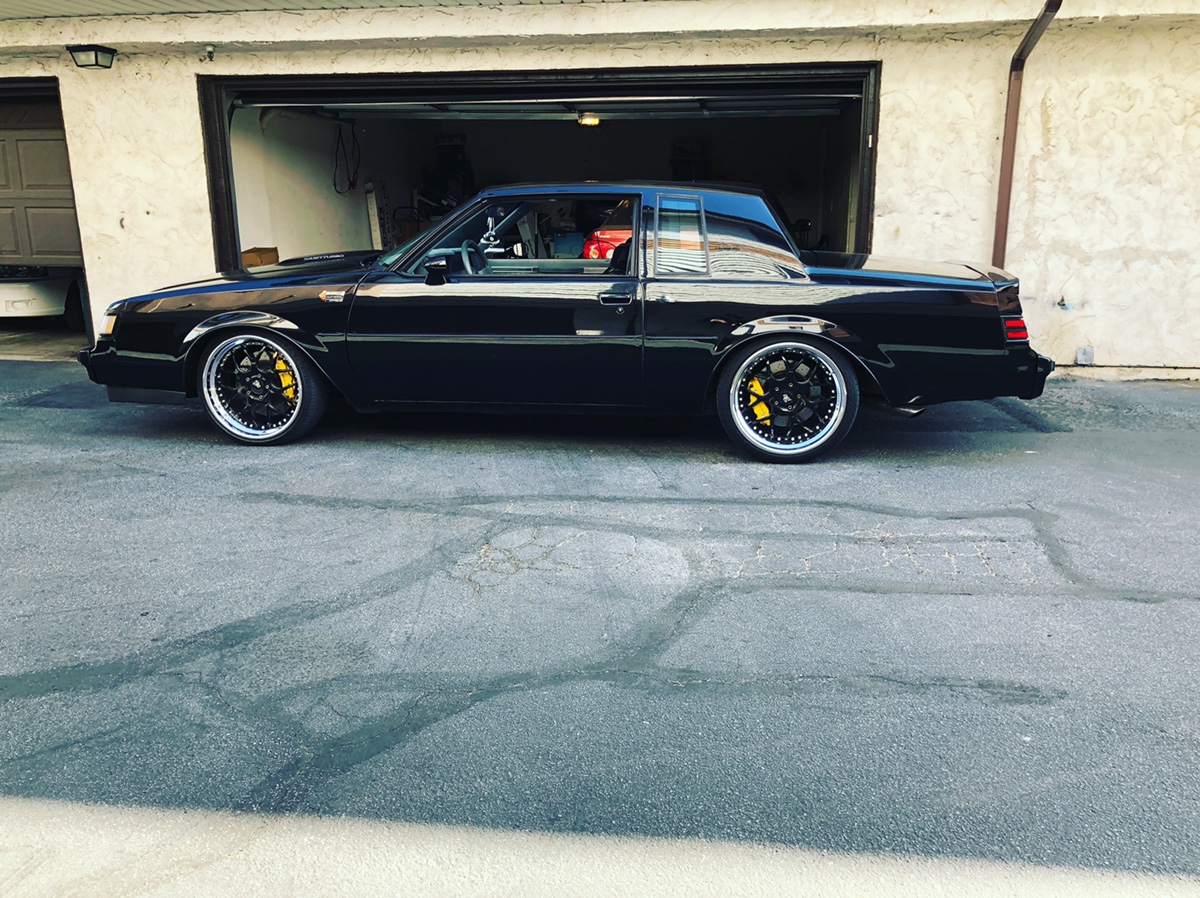

I just love this car!!M&H 325/40/18 (28"tall tire)on a 10" rim with no frame mods needed at factory ride height, just remove the trim on the outer lip and roll the fender.

Wheel size:
FRONT: 18x8
REAR: 18x9.5
Back spacing:
FRONT: 4
REAR: 4.5
Tire size:
FRONT: 245/40
REAR: 285/40
Make/Model of tire:
Nitto Motivs up front
Nitro 555R out back
Make/model of wheel:
Centerline Lazer II

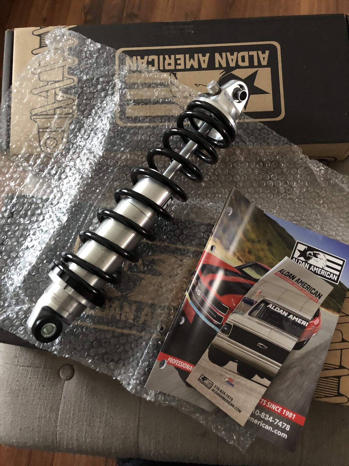

How do you like the aldans? They’re on my list. Car looks greatInstalled these over the weekend.
New stance
Still need to roll the fenders, but sits niceley
Wow looks awesome!How do you like the aldans? They’re on my list. Car looks great

17" Simmons. 275/40 and 245/40. Stock suspension for now.Nice ride!!
What’s the specs on the tires, wheels and suspension?
