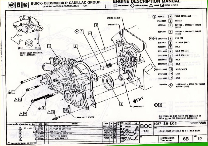

I just put on my front cover and do not recall the washer either only the oil slinger... That was the 1st thing I noticed on the picture he posted and I was wondering the same thing you were!!! I see on the diagram it does not show one so wondering where that came from :confused:

Looks like it was a steal housing for the rope seal that seats in the front cover as you mentioned. Just never seen one like that.
Thanks guys! I am guessing the steel washer is to set the depth of the balancer for perfect belt alignment? It's definitely something factory.

A second washer is more likely for crank trigger clearance than belt alignment.
