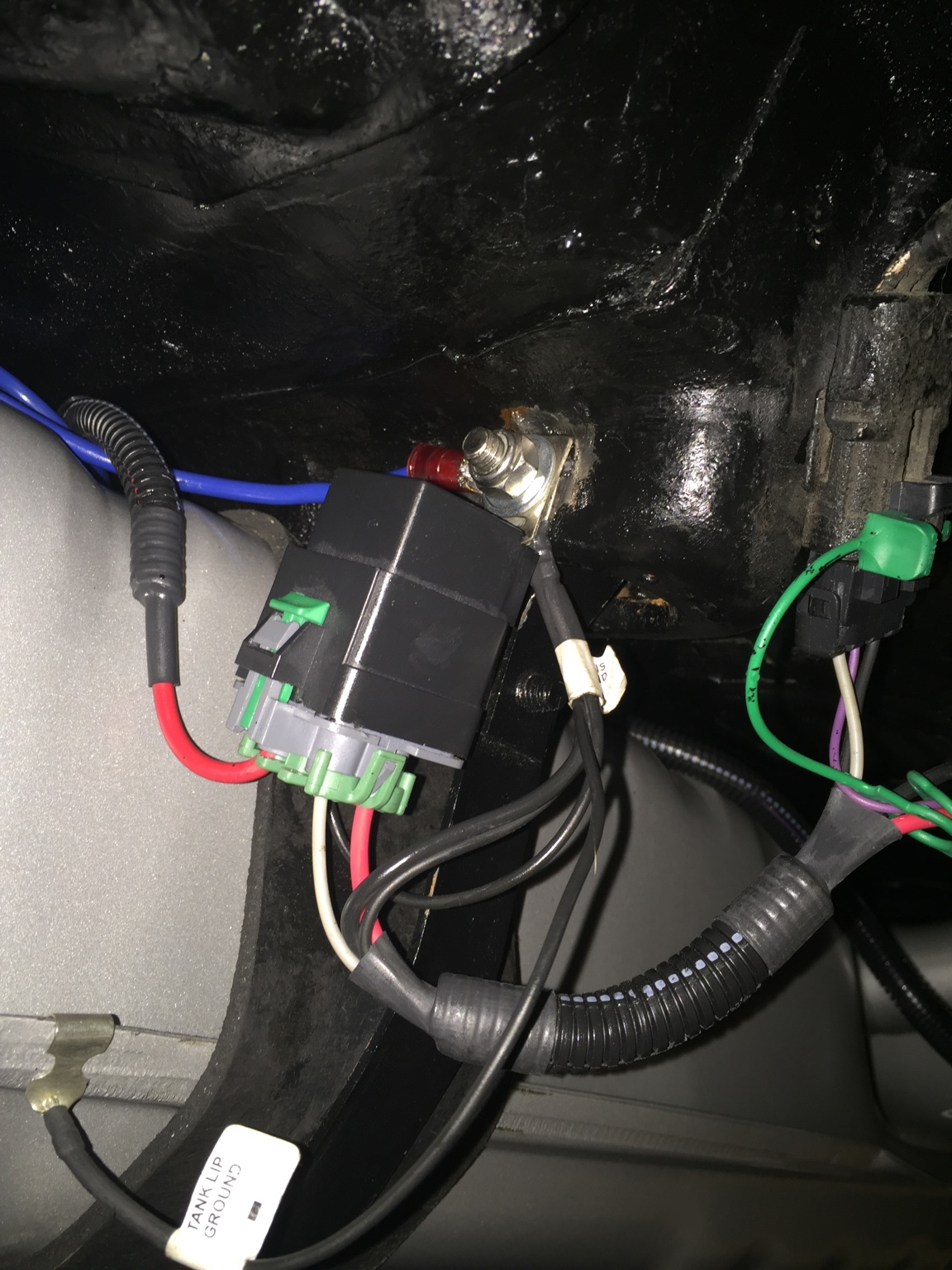

There you go. Blue 10 ga wire is the battery negative.
Quoting because this is what I am going to do. I bought the G7 hangar assembly and melted the original and a secondary harness. Likely because of poor grounding. The wires burned up at the ends in the connector. On the replacment G7 kit the wires separated from the connector before I could even install it.

Yes been running 450 walbro on e85 6 return 8 feed 25lbs boost no issue except having to upgrade the ground wire cause fried the wire's inside .also need volt booster.
