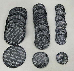

The best was to plug a tire you car about is with a plug patch. It's basically an inside patch with a tit in the middle that acts as a plug so it's the best of both worlds.
https://www.amazon.com/Hanperal-24Pcs-Rubber-Repair-Patch/dp/B01NADRACD
