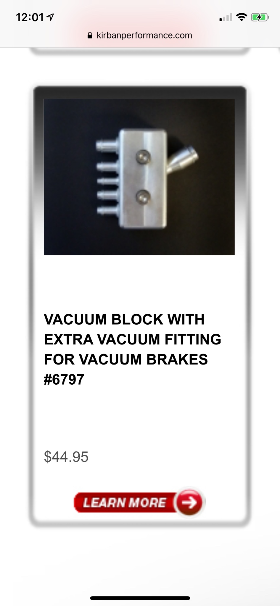

my vacuum brakes are teed into that line is that bad instead of having it off the block up top

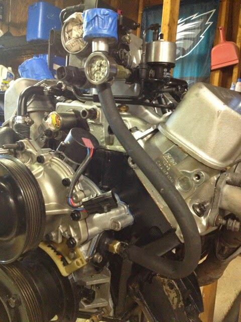

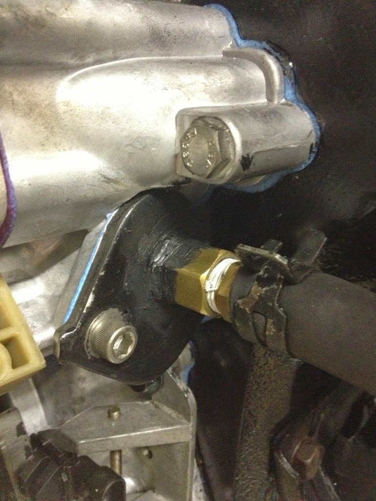

I love this set-up. I assume this is a one off and Racetronix isn't selling them correct?I don't see the need to lose the PCV. I still have a fabbed up version of it on my car. The key for this system to work effectively imo is the use of a valley pan under your intake manifold similar to the intake gasket that came stock. Something needs to be there to shield oil from splashing up into the PCV and coating your upper plenum. The PCV is essentially a check valve, so I got rid of my vacuum block on top of my throttlebody and run a intake spacer for my vacuum sources that keeps anything from soiling the upper half of my intake. Having a alky kit also keeps everything really clean too. While my engine was apart years ago, I took my intake over to Racetronix and we custom made my new PCV system you see below.
View attachment 334205View attachment 334206View attachment 334207View attachment 334208
