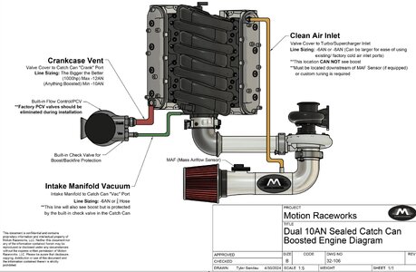

Motion Raceworks 2 Stage Air/Oil Separator?

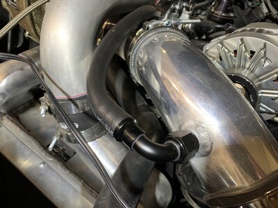

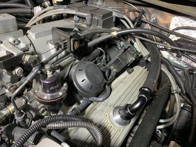

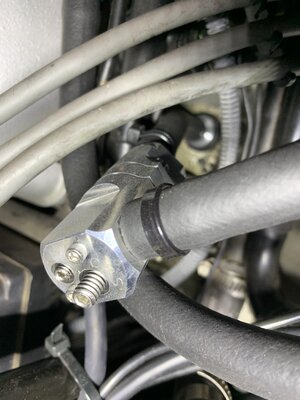

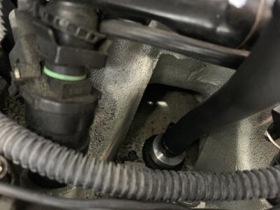

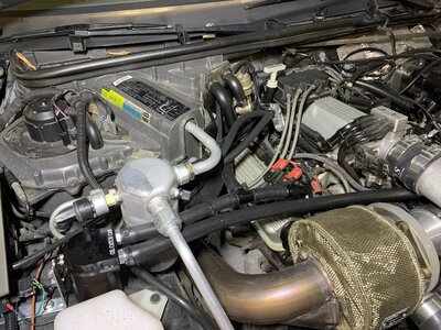

The PCV upgrades seemed to have fixed the high idle BLM issue. Still need to put some more miles on it before I know for sure.
Here’s a few pics after I cleaned up the driver’s side valve cover connection. Both valve covers are teed together before the catch can, then connected to the MAF pipe.
