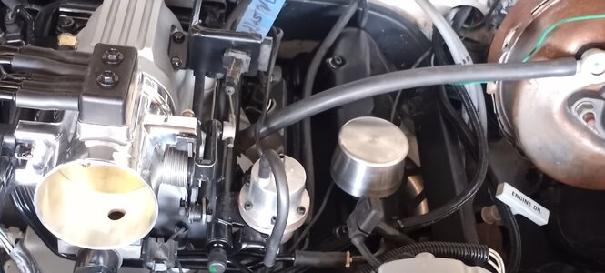

When I had my manifold off for porting, basting, and painting, I deleted the EGR boss inside the manifold, welded a plate over the hole in the floor, drilled a 11/32 hole in it, welded up the EGR boss, and drilled and tapped a 1/4 pipe thread into it on the port to the inside if the manifold. The lower port connects to the exhaust crossover. I welded those shut too at the manifold flange. A 3/8" hose barb allows a straight shot with a short hose to the booster. It looks clean and factory!

Pic of the new hose to the booster!

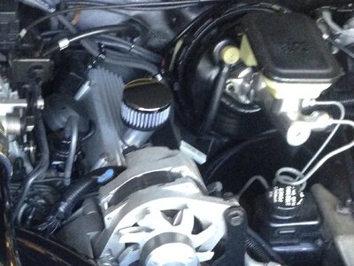

I chose to route the hose behind the plug wires, under the coil/ module mounting plate to a tee right above the PCV valve. I like how it’s more hidden. It’s been working very well since ‘96.
Just another option.

That works with a stock or small cam, but the PCV valve is a constant vacuum "leak" and will reduce the vacuum to the booster if it's "Teed" off of it. If it works, cool! If the vac is too low, you need a different way.
I have a .589 lift roller, so I did it this way.
Whatever works for all you folks! You have alternatives!

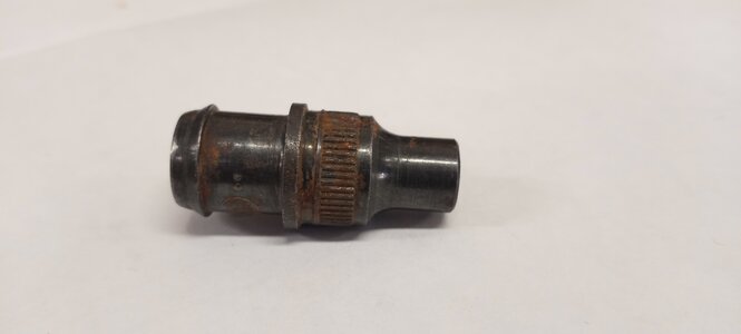

Put this in line between the plastic one and the intake manifold. It will absorb the boost and take the load off of the plastic stock valve.
