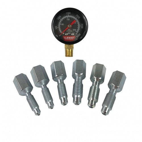

I/we use a brake pressure gauge to see what is REALLY at the wheels.

MAX ft wheel psi with max pedal pressure = 650PSI. Should be at least 1200.
Tried 3 pad combos.. Still no stop.
Hydraboost: Same brake combo. 2100PSI!
At those pressures I smoked 2 sets of pads and one set of rotors, just testing.
Went to EBC pads, required I use reduced pedal effort.
A brake pressure gauge is not expensive.
