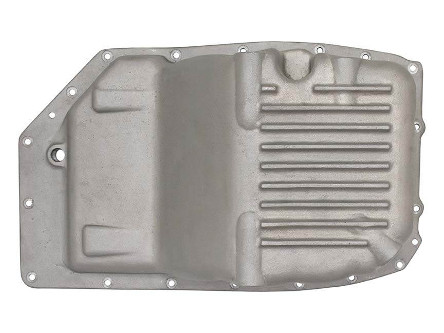

see if they make a bigger pan for your tranny extra fluid will help , just an easier route .
I also run a cast aluminum finned deep sump pan.
Whale oil was a key ATF additive that allowed auto trans to survive. No more whale oil in ATF. Try to keep your trans at 160 degrees if possible. Extra cooling & extra capacity .
