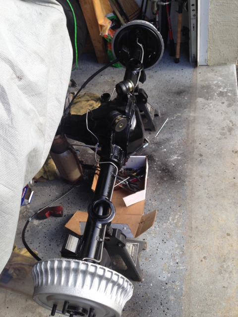

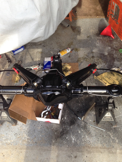

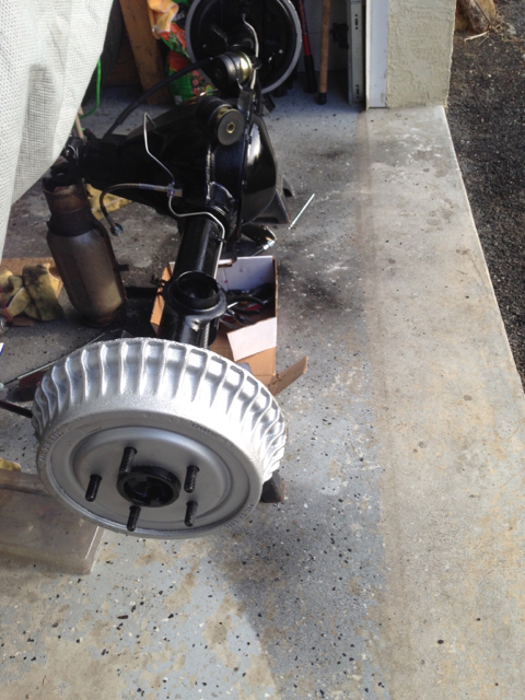

Just did mine. I'm not big into shows, so didn't go overboard. I degreased with brake clean around the cover, only oily spot. Then wire brushed with the cylindrical brushes Eastwood sells. Wiped down with wax/grease remover. Then a couple coats of Eastwood texturized rust encapsulator. Then Eastwood Extreme Chassis black. Attached it to the freshly boxed control arms with new bushings and new bilsteins. And powder coated with new ta cover in clear so it looks good for a while.

I used Eastwood chassis coat, Hit it with a wire brush and sprayed it. The cover got semi gloss black powder.
Before
After
All the control arms got semi gloss powder too
I took mine and got it sand blasted. Use Eastwood Extreme Chasis Black on top of primer. Did this on both cars the SS brake lines make it.
