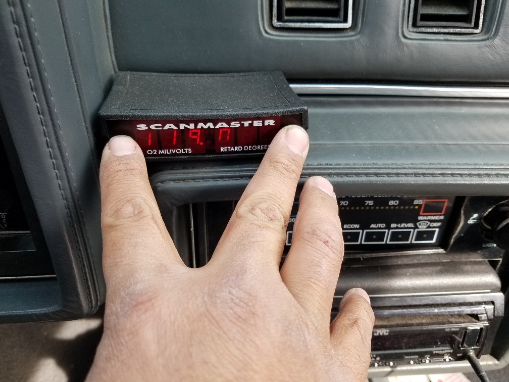

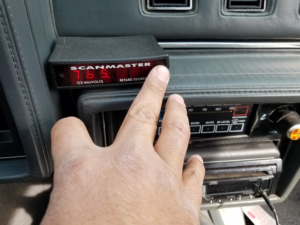

Put in a new fuel pump a dw300 well on lock down.did a couple hits on the back road.no e.t
765 /0.0 retard
@119 MPH.
Boy was I cooking!
Your numbers on the Scanmaster look good. 02 millivolts are where it needs to be and no knock is great. Looks like your Scanmaster housing is warped, could just be the photo.
Add some high gear fuel to it to give yourself a safety margin. Temp/humidity drop just a little you'll be into KR.
Scan master is sun beat an still kicking.
I'm running alky on 5.5/6 I'll turn it up.

I think he means add high gear fuel through the chip/ scanmaster.
