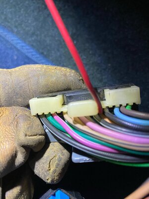

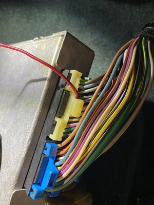

Not exactly sure what pin location this is but here's what I've got

Looks like it goes into pin D-11 on the 32 pin connector. Which according to my info is a “not used” terminal.
Unless it goes into C-11 which would be the air temp terminal.
What wire is the red wire spliced to on the SM?

I see now that there's numbers on the connectors. While my wire colors don't match the diagram above, my spliced in red wire to the Scanmaster is on pin D11.
See post #7 or #9.
D-11 is not used & your white wire should be going to pin "E" on the ALDL connector. Looks like instead of a splice they just ran it to the ECM. Though there's still a splice between the red & white wire.
Got it, just the white wire from the Scanmaster to ALDL pin "E". Don't understand why previous owner would have gone through the effort to connect the white wire to the ALDL and a not used pin on the ECU, but oh well.
