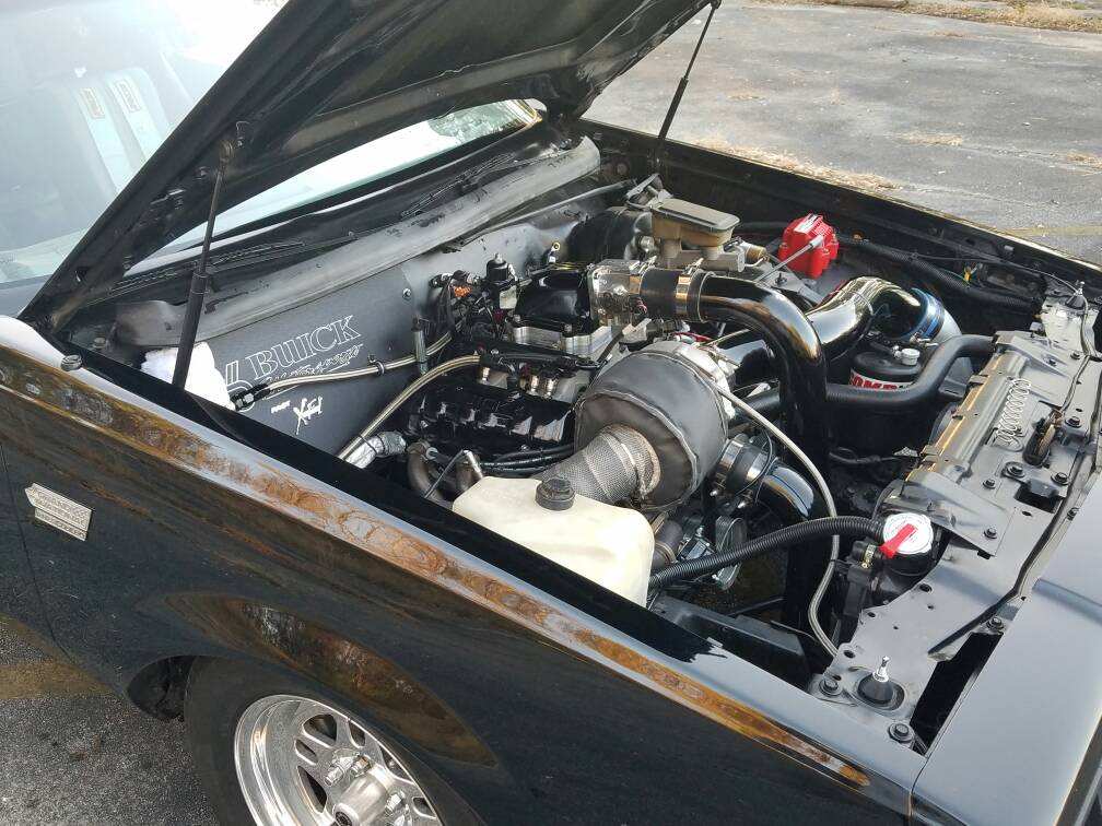

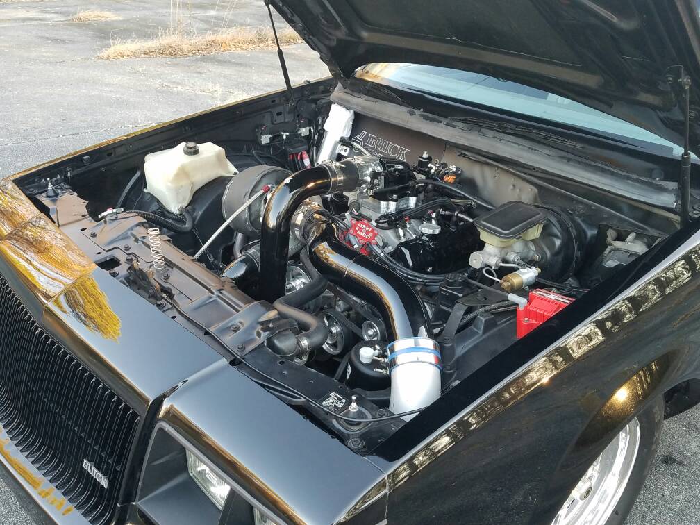

4in GN1 one piece intake pipe. You'll need the angled IAC boss and if you have 3in intercooler piping you may need a spacer. Mine seemed to fit without one since the GN1 headers lowered the turbo slightly.
Your engine bay looks nice. Have any pictures from other angles? That thing would stick out like a sore thumb in my all stock/original engine bay. nice car man.
Thanks. Yea that is true if your engine bay is otherwise stock. Maybe someone could reproduce an original looking pipe just longer to hook up to the stock air box.
