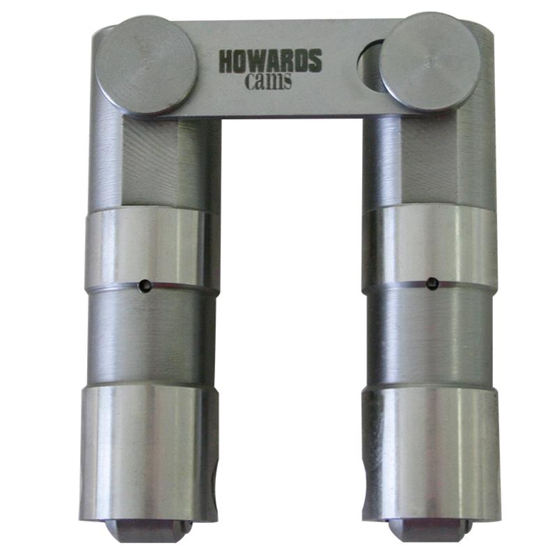

Half are Chevy? I have these in a stage motor.
Update. I’ve ordered a set of speed pro lifters. Seems they’re made by Johnson maybe? They were a deal and in great condition. Seems through research that they’re all the same as melling/johnson/gm.
