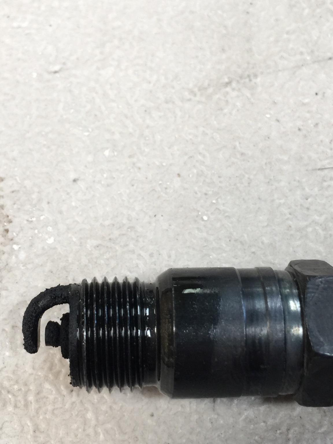

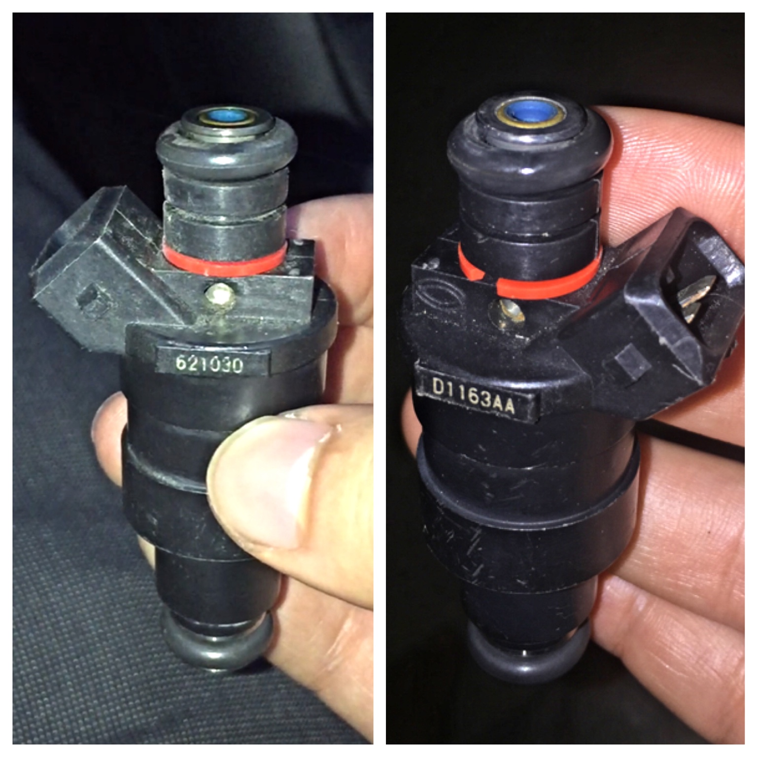

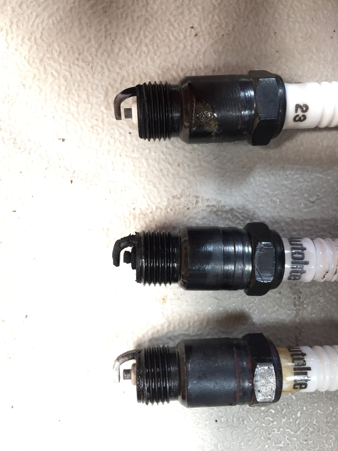

They were not run on E86. I pulled all of the plugs (autolite 23) and they were all blackened. A lot of carbon deposits. All gapped at .28 . I'm guessing the error is all of them at this point. I did not verify the condition of the injectors. At that time, I did not know that being left out in the open air would cause trouble. The car does smell like a gas station though. Verified and Fuel pressure is set at 43 line off.Did you verify the condition of the injs you were given?
If they were used, and left in the open air, they may have "issues"..
A 42# inj run at commanded pulse widths based on a 38# inj could cause some issues. However, I don't think that error would be showing on only that 1 plug.
If those injs have been used, not lubed and kept out of open air, it could well be there's sticking, leaking going on.
They weren't run on E86, were they?
Yes sir. I bought the injectors and the chip upgrade, along with the powerlogger, from Eric@TurboTweak.You'll need a chip that matched to the 60s...
