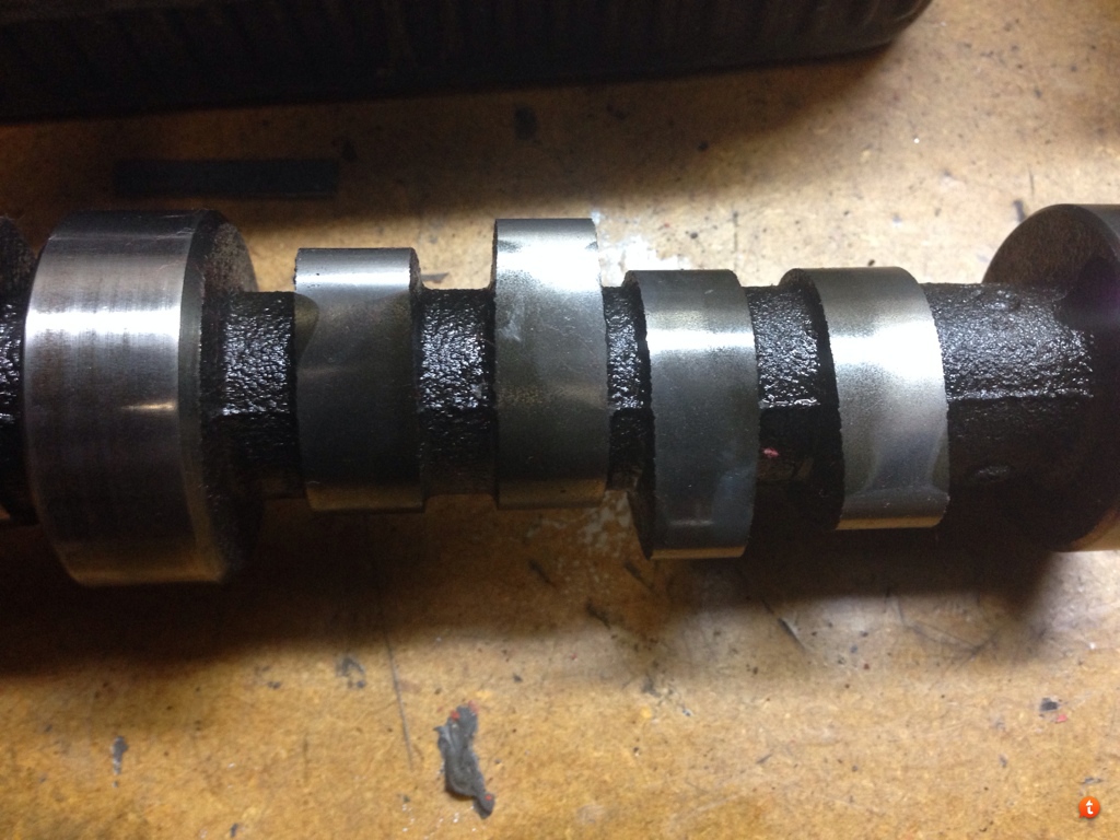

Here is my cam tell me if this is a good cam and if it looks good!
So let me know what you guys think!
the only way to know is to measure each and every lobe first. If one lobe is shorter than the other, it's a boat anchor (and the engine has to come ALL THE WAY down)
You will also want to take a look at the back of the cover where the cam button was riding and make sure that isn't gnawed up.
Thanks for the tip! I will check that!
On another note is anybody running this cam??
I do not use flat tappet cams any more. They all go flat. I use to have cams stacked up like cord wood in the corner of the shop. Roller or I won't build it. They have cost me way too much in warranty replacement. (I stand behind everything I do)

The #3 exhaust lobe is off center to the cam compared to the others. They lifter doesn't like to spin on that lobe. Casted from the factory that way.
Sent from my SAMSUNG-SGH-I337 using TurboBuick Mobile mobile app
#3 exhaust lobe is a problem and a Buick V6 has a very small base circle. There are 5 lobes tapered one direction (to spin the lifters and center the cam in the block) and 7 of the lobes are tapered the other. (On factory cams). Most cam grinders do not do this. They typically taper them 6&6. Comp was notified years ago about this. This must be checked prior to install. (Along with deburring the oil transfer hole to dist. gear on the thrust face of all cams). I just pulled a completely stock GN engine apart that ran 11.19's and it was the first and only decent cam that I have seen in over 25 years of building them. Still putting a roller in it though.(and stroker kit.)
