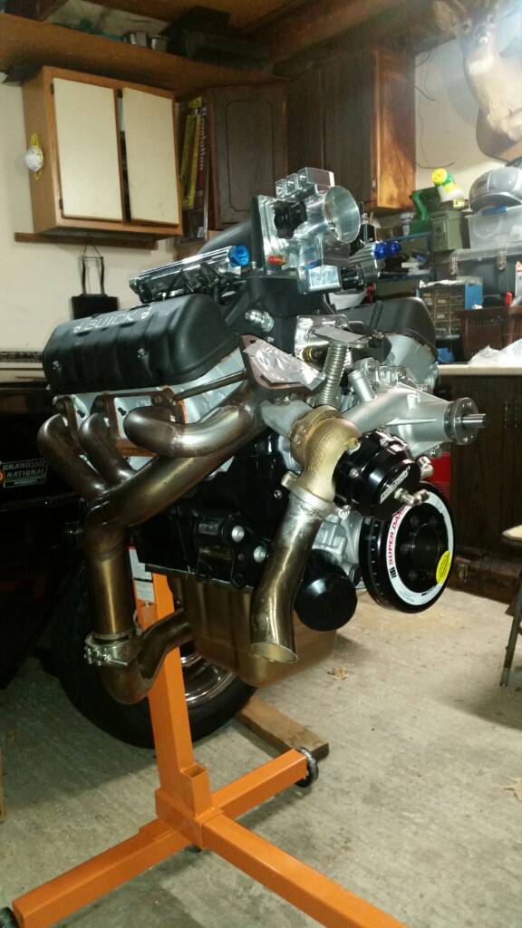

Seems like a hit and miss type of situation. I guess I have a set that was made on a Wednesday. lol, No issues with leaks... Let's hope they stay that way after I cut into them to make a twin scroll setup with 2 wastegates.
