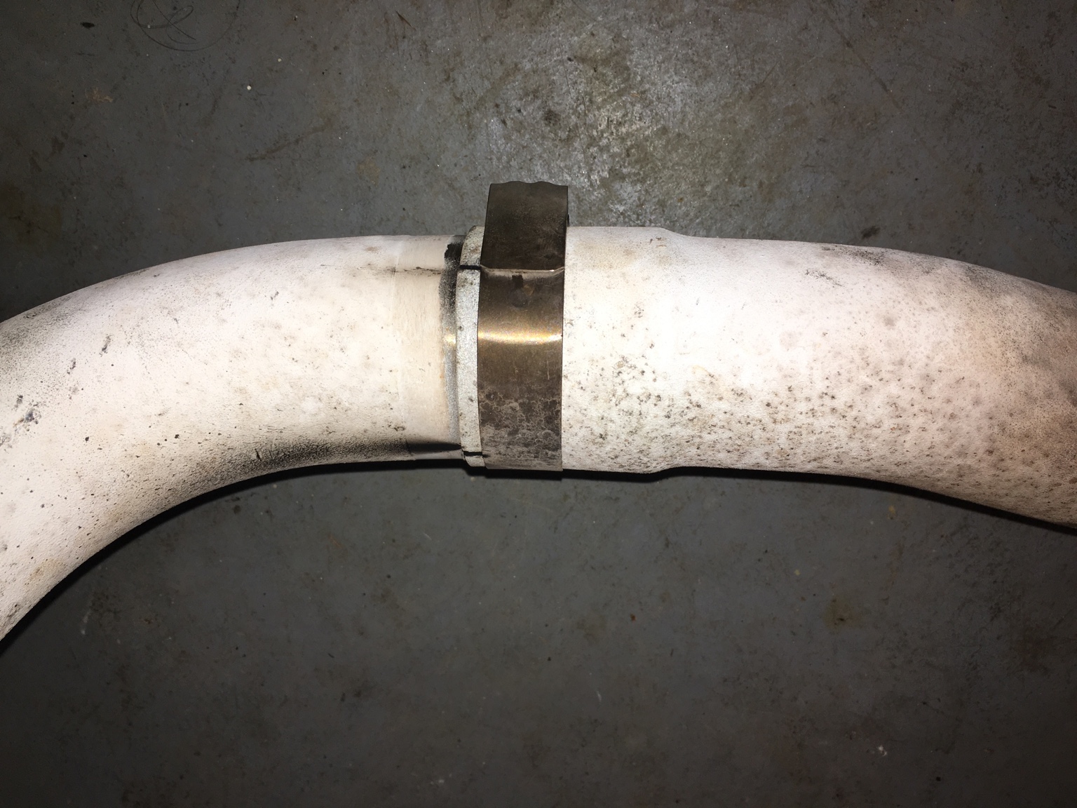

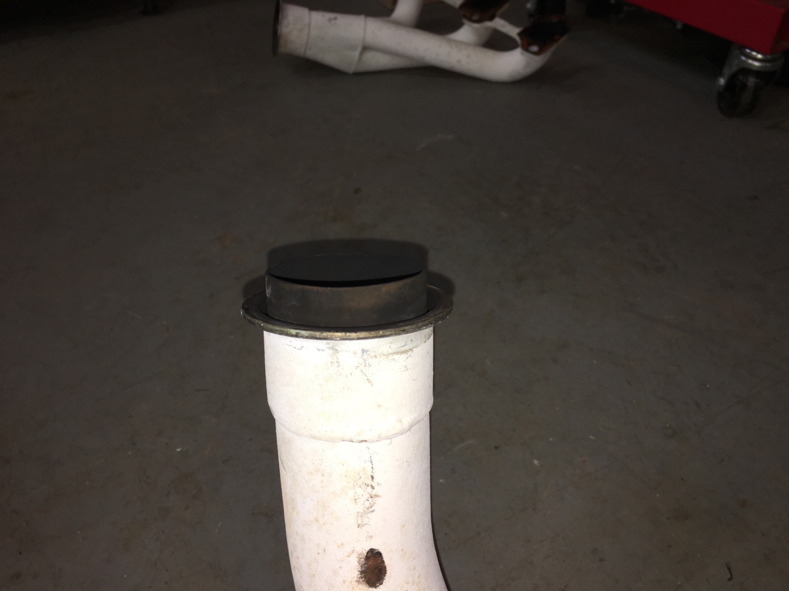

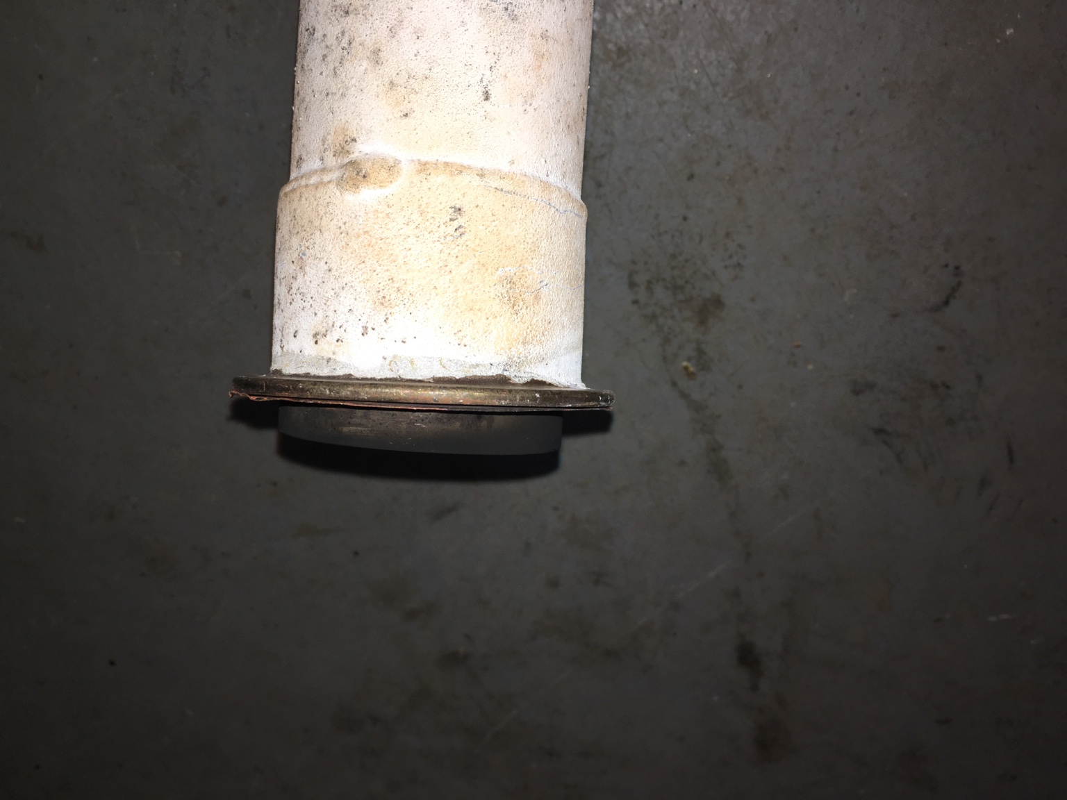

The more we discuss I feel it is becoming more and more apparent the crossover pipe being cut, or not made correct is the issue.
SignUp Now!That is a cheated cut or bend.. its a No No .. if this was done on a jig .. never could have happened.. maybe its a fluke or the fabricator was having a off day .. but the match up with the vband and mating pipe isnt right
I think the cut was performed on the band saw and was not straight. It was welded on straight to the pipe but doesnt have enough "meat" to enter the header. I have constantly commented about this issue but most have said the sealing surfaces should be adequate to make a positive seal. I am glad people are starting to understand.
