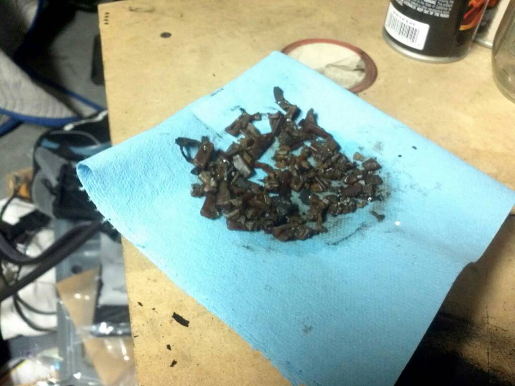

Finally enough time to make some progress here. Pulled oil pan and here is the timing gear debris. I'm do everything with the timing cover and new water pump, will be installing everything this week. Fingers crossed :-)

How'd the oil pick up look?
Haven't cleaned it yet, thus is what it looks like.

Damn. I went back to page to re-read this thread and it looks like I nailed it. It would appear the previous owner stripped a timing set, slapped a new unit in place and sold the car. I can see being slack about not cleaning the oil pan, not replacing the pickup, or getting a rollerized cam button.... but why in the world would you put a $100+ timing set in there when you're just going to dump the car (and leave another set under the seat)???
What really sucks is you still have a stock pickup with a bypass flap in it. I have a feeling your oil pump cavity is torn all to hell. Even then if the leakdown numbers look good it can still be an easy repair, just more money.
If the oil pump is torn up, it might not be a bad idea to inspect a couple bearings while the pan is off.
