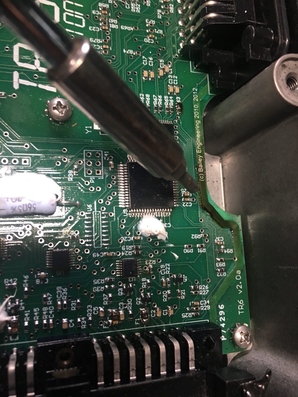

So I’m still having issues but think I found the problem. I sent the box to Bob he figures it’s repairable.

Were you hitting rev limiter in chip? Still doesnt explain the burnt trace in the TR6
it would not rev past 4000 rpm was weird could not figure it out for the life of me. The burnt trace I'm going to account for that with my main ground from the battery being loose creating resistance this could have taken out the coils too I will wait for Bobs answer when he sees it.

Mr Bailey is a scholar and a gentleman, fixed the TR6 and sent her back said no charge that was no good sent him enough for a bottle of scotch on top of the freight he always looks after us the Buick community is lucky to have him!!!
