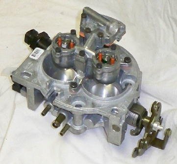

Ok guys, some may remember a few months back me doing several things to get it to run right, ended up being a fairly new fuel pump had gone bad. Here I am several months later and it acted up again. Changed out the fuel pump and filter. I cleaned out the throttle body and put a new gasket kit on the TBI. When trying to start it, it will turn over a few times then lock up like it's wanting to backfire, then start turning over again. After 15 seconds on the starter it will slowly start firing up and then run. I can run it up and down the street, but if it is put under too much load it will stumble like it's not getting enough fuel. The new symptom is the backfiring and stopping the cranking while trying to start. Any ideas? I put new plugs and wires on it thinking that I wasn't getting enough spark. It has a new coil, and ign module, no cat, clean egr, new temp sensor, and a few things I'm probably forgetting. Truck has just over 70,000 miles on it.

Yeah, I've heard nightmares about those, and it's an expensive part. I think those are '94 or '95 and up for the v6 and '96 for the v8. My '92 is just a simple spring FPR and 2 injectors shooting into a hole for each bank. Basically a carb with 2 injectors instead of floats and bowls. Much more basic and easy to work on. I can have my TBI off apart and back on in 15 minutes.

Ok, rather than start a new thread and try to explain everything that has been done to the truck, this thread has it all, but I have a new problem. Was merging on the highway, semi beside me so I went to accelerate, the truck downshifted and backfired. Let of the gas and it ran fine. A few days later I'm cruising along about 60, the ac clutch kicks on and it backfired. Had been driving for 10 minutes with the ac on. Turned the ac off and it ran fine. Got home, turned the truck off and an hour later it wouldn't start. Injectors were not spraying. The next morning I went to check it out, and it was running fine. Later that day it wouldn't start and hasn't started for a few days. Injectors aren't spraying. I took the TBI apart to see if there was a blockage, and its fine. It will fire with gas poured into the bowls. It has a new ICM and I swapped out a known good ICM with now change. I bought a new ECM, swapped out the chip, no change. Some sensor or something is not letting the injectors fire. I've been on several boards trying to figure this out with no luck. Any help appreciated.
