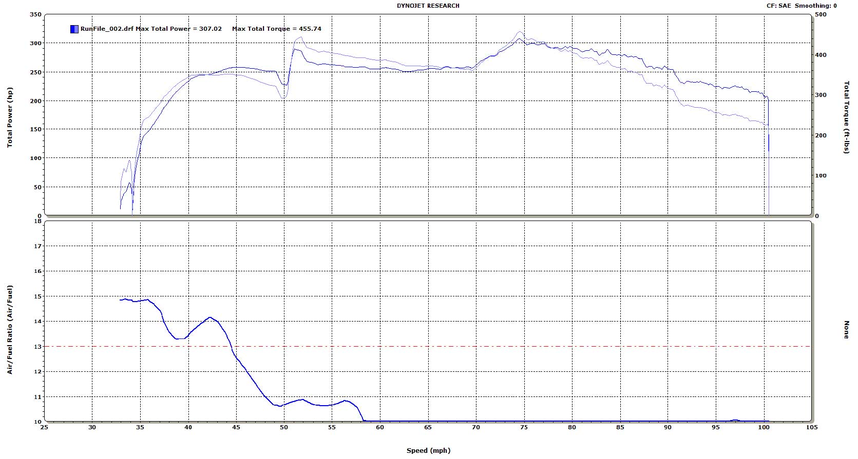

Well I figured since I'm pushing alky, it would fit in here.
Although I'm not upwards of your guys' numbers.
307 awhp
455 ft-lbs
I'm stock motor/turbo, 100% methanol, stcok fuel pump/FPR, NO tuning on alky yet (you can tell by my REALLY rich running), 23psi. Intake temps @ 71 deg for the first run, 93 deg on the last run. You can see that I flatlined on my AFR....... I didn't think I could do that with stock injectors @ 23#. :eek: I really need to get my DIY-WB finished and in the truck. I liked the TQ numbers though...... I'm sure I could squeeze out more power with tuning. But I probably shouldn't push it with a 130,000 mile motor. :o
I think there is substantial power there that is free for the taking :D Lets just say your A/F is pretty safe!
From what I saw of Julio's car on the dyno, with alky a 12:1 A/F works pretty well with these cars.

Yeah, I figure next time I'll go there with 4 or 5 different combos on the multichip and try to dial it in. I'm probably not going to put too much time into this motor though being at 130k miles. I think I'm just going to hold off until I do the next big build. :cool: Like you said........I think I'm safe at least. :)
