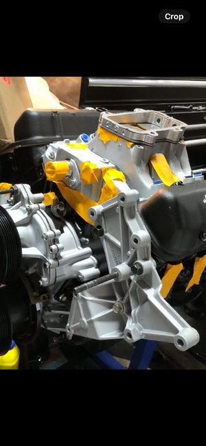

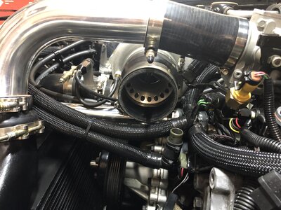

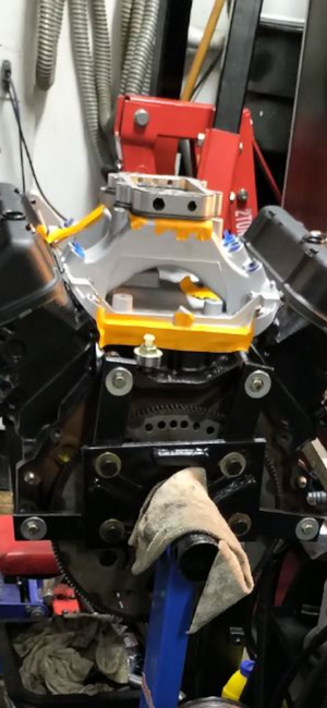

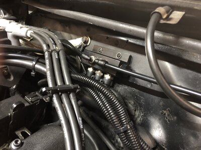

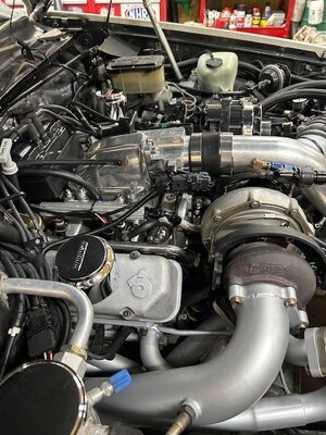

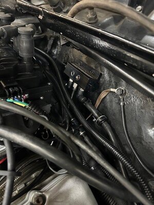

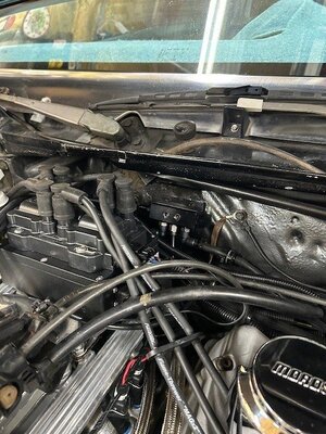

My Cruz plenum spacer was ordered with (2) NPT holes in the front of the spacer .
Fits great & works well

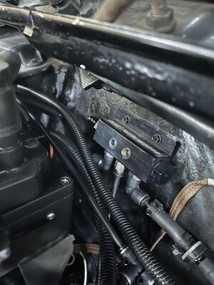

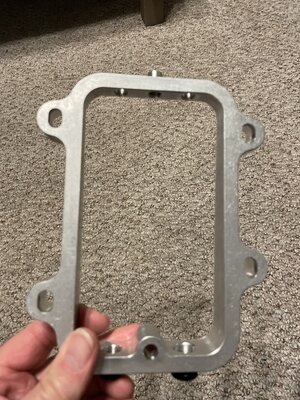

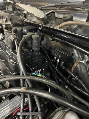

Found a more clear pic
The spacer from Don came with NPT holes front & back & plugs to close up which ever ones you decide not to use . I opted to use front NPT connections into push lok fittings

Looks great….. what did you guys use to connect to the hard push connect line to connect to rubber hose for like the fuel pressure regulator and stuff?
No push connect fittings on my car, but when we do need to convert push to connect to rubber hose we use a 1/8”npt adapter to a 1/8”npt hose barb fitting
