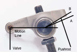

When the shaft height is right relative to the valve tip, the pushrod should also be square with an imaginary line from the shaft to the centerline of the pivot ball.... Now for the bad part.... it won't be. Jim Miller holds the patent on correctly built rockers and he doesn't make them for our Buicks. (and from talking to him, they never will be)
"A" is what you shoot for, not "B"
One way to figure out the correct shaft height is to see how far the pushrods are out of square, then average the two. (on my engine, I lowered the shaft height 050"). That will get close with the parts at hand. Once the rocker height is correctly located relative to tip height, THEN you measure pushrod length. (then check everything for square, try and figure out what you did wrong, then do it again. LOL. Doing this right is defiantly a 'feel thing')
