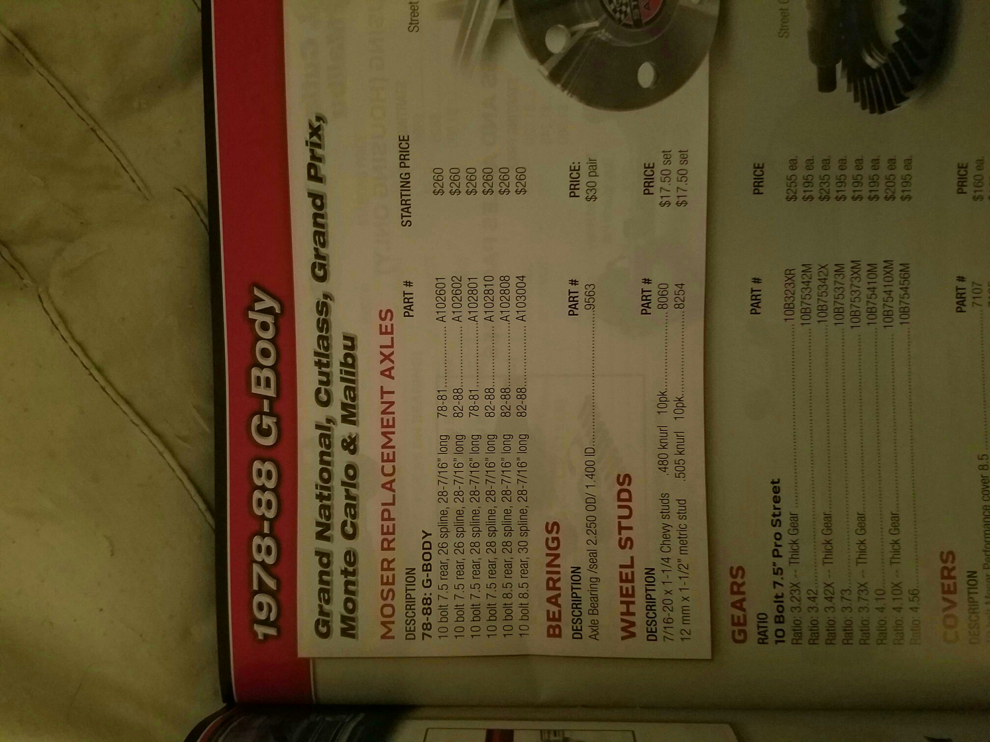

What about the knurl, how much would a .004" difference play into installation? Studs from Moser have a .505" knurl and ARPs are .509"

I wound up deciding to get 3" studs over the 2 1/2" and Moser's site didn't show any 3" so I'm going to have to order them somewhere else and put them in myself. But I still have a question about the knurl, going back to my example about Moser's and ARP, does the difference in knurl effect anything in regards to installation?
Did you call Moser ? A lot of times vendors have products not shown on the website. I find it hard to believe that an hi po axle company doesn't offer 3" studs for their axles .

Here is what I used on on a quick performance 9" with moser axles
Thank you, this is what I was looking for originally!
